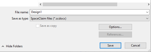

Please can help anybody!
I have installed Spaceclaim 2025 R2 but have in open and save folder no Fileformats for im- or export
In earlier Version we had a special button in installroutine for fileformats but in new installation 2025 R2Â i doesnt find itÂ
A short solution is very welcome
Thanks Bruno

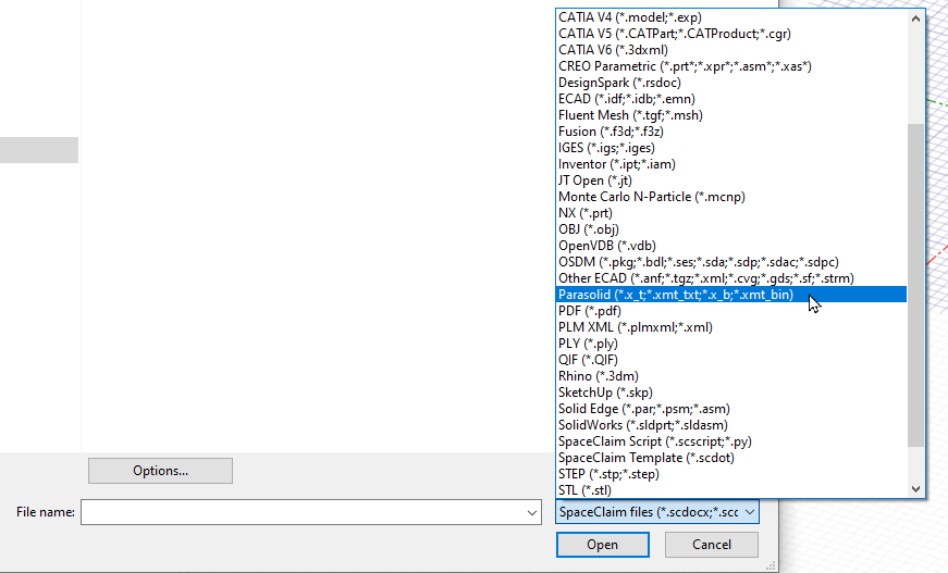

SubscriberWhen you start SpaceClaim, use File, Open and click on the Type button to show a long list of files that can be opened. This is how you "import" geometry from other file formats.
Are you asking about an Ansys Student 2025 R2 installation? When using File, Save As, the free Student license is limited to saving only in the .scdocx format.
If you are using a Commercial or Research license, when you use File, Save As, you will see a long list of file types to "export" to.

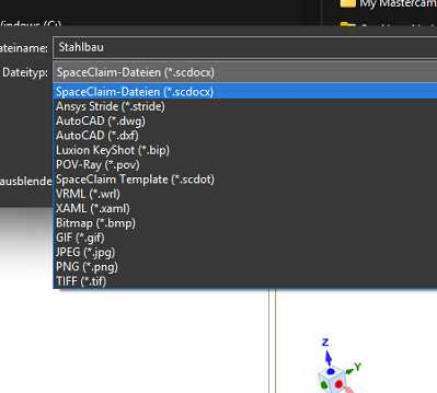

SubscriberHi at all
Thanks for answer
we are using Sc 2025R2Â Â , as commercial licence, no student licence
Yes i am missing the list with different fileformats how you show it by import and export in your printscreen, i have in open and save as only the small value how see in my printscreen
Thanks for help

SubscriberHello
in earlier version exist in install routine a special button for install the CAD Fileformats ! In 2025R2 i am missing this
