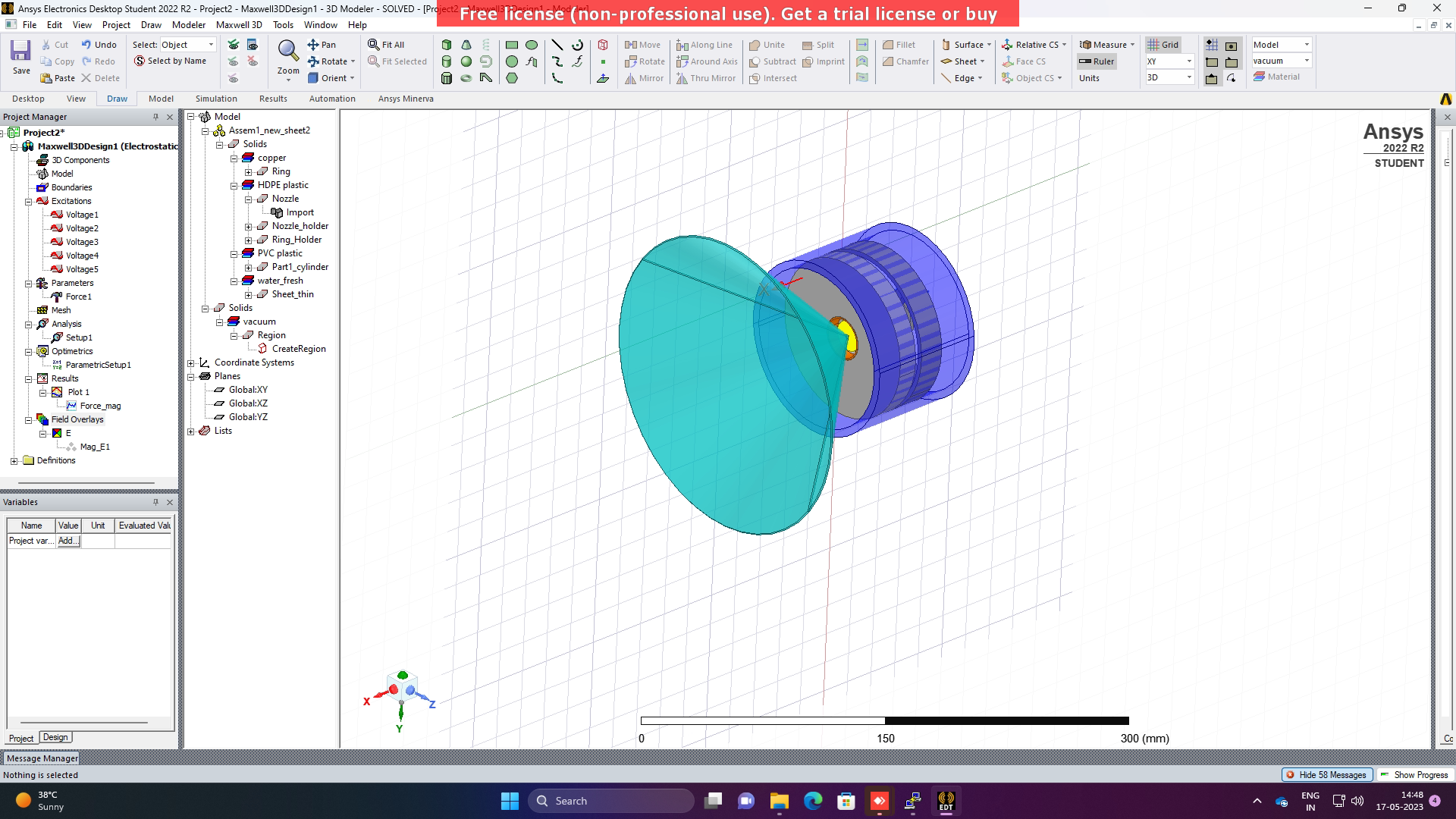

      In Ansys Electronic Desktop Student, when I tried to see the B or H plots of a solenoid that is excited by current, field overlays doesn't visualize neither magnitudes nor the vectors of B and H. Then even if I simulated the ready examples from here, Ansys website, it still doesn't plot and the "3 dots" of the associated field is always gray which should be colored when showing the plots. Could anyone help

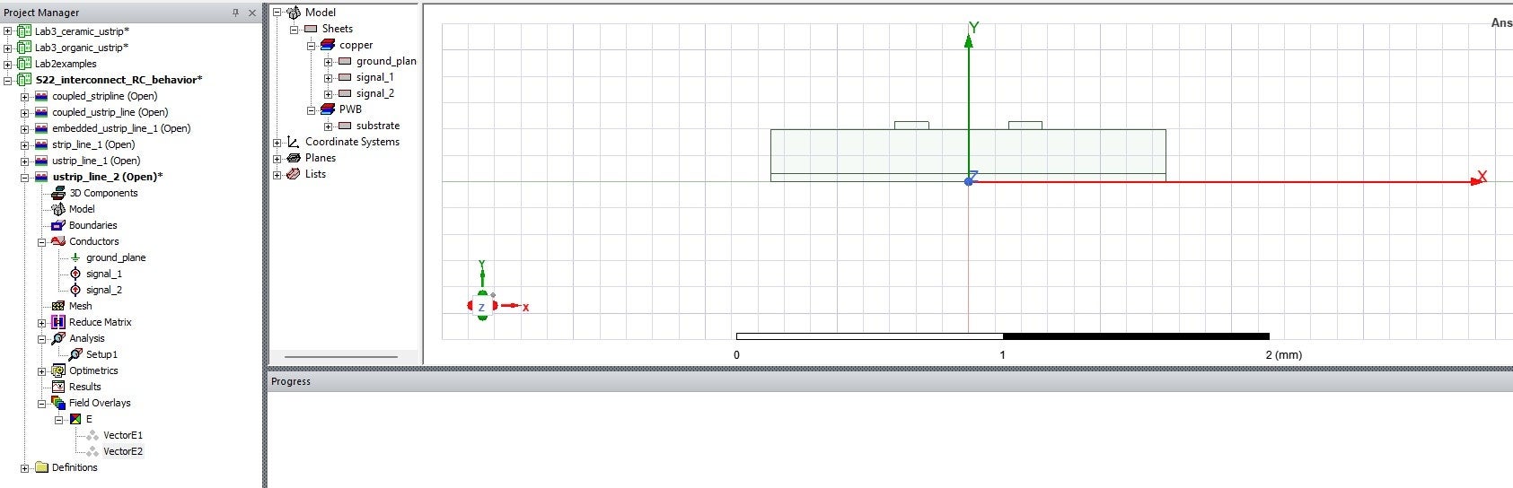

      I have the same problem but for a simple 2D geometry... what do i have to do to fix this? I tried everything in the list above.

      I have a coil carrying current inserted inside the 3d rectangular plate. I wanted to plot ohmic losses. I tried to plot it but it doesnot show plot. However, i run calucator for ohmic losses, and it gave some values. It plots B mag though. Can anyone please solve this problem?

        2) If Yes, Share the screenshot of the Model you have simulated for the plots.
