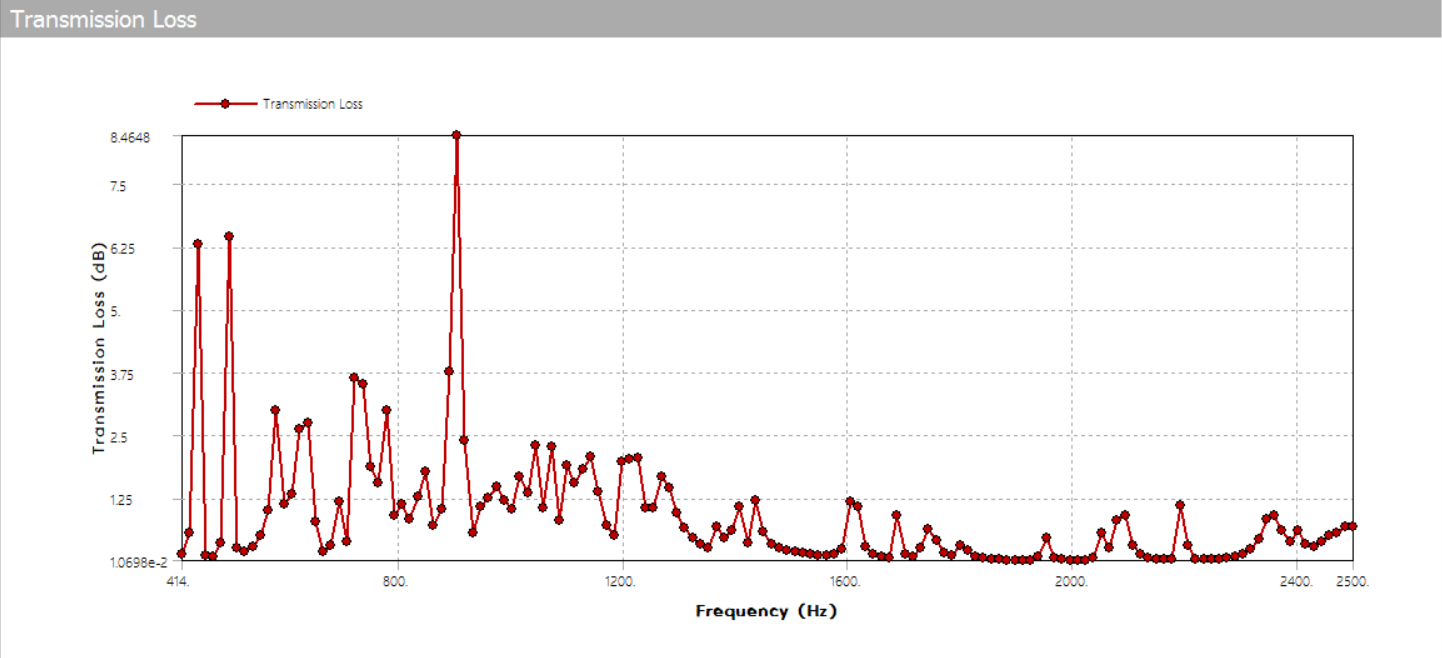

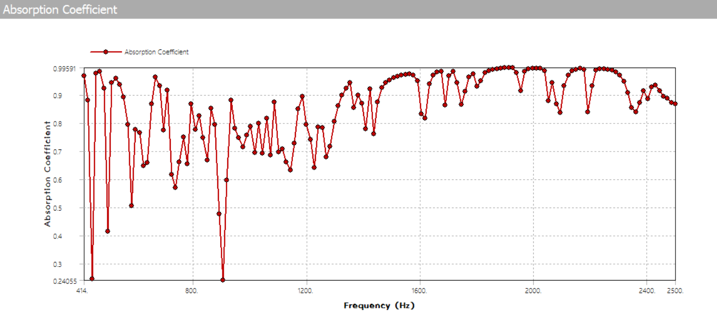

SubscriberHi, I'm designing helmholtz resonator as silencer and i want to ananlyze my model how much this model can reduce noise. i use Harmonic-acoustics, but transmission loss and absorption coefficent have shown opposite results. as you can see, at the frequency(Hz) where transmission loss is low, the absorption coeffiecient is high. i want to know which of transmission loss and absorption coefficient shows the amount of noise reduction properly.

Forum ModeratorHi,
Please refer to this link for the formula to both the terms: Acoustic Power Loss Results (ansys.com)
