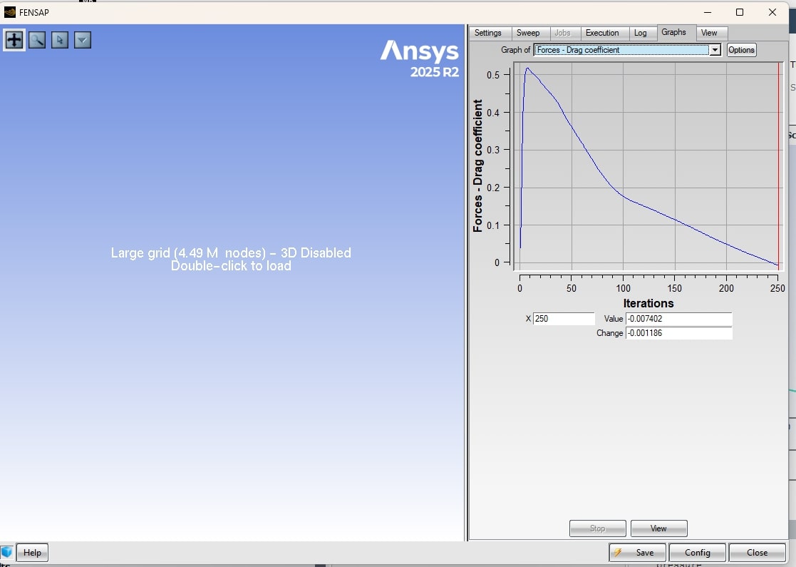

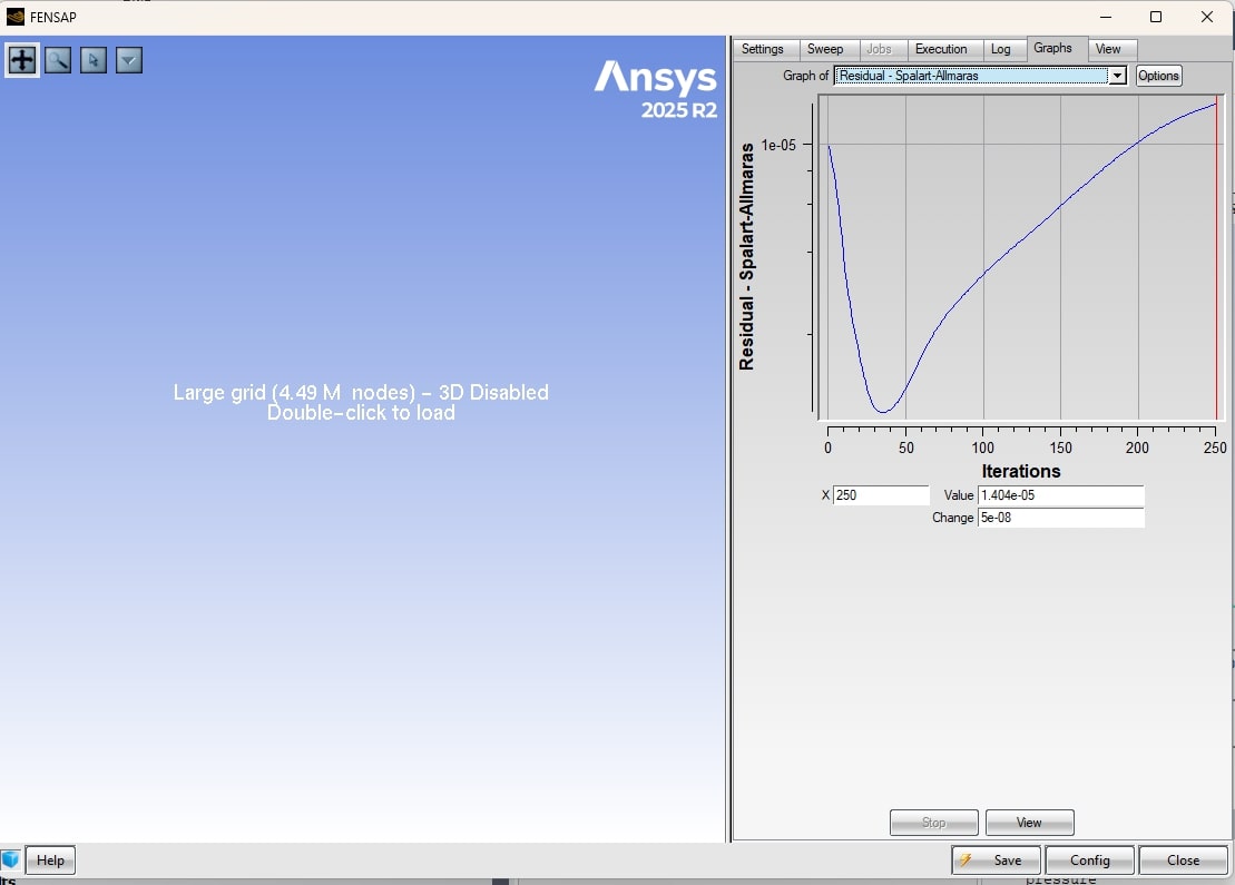

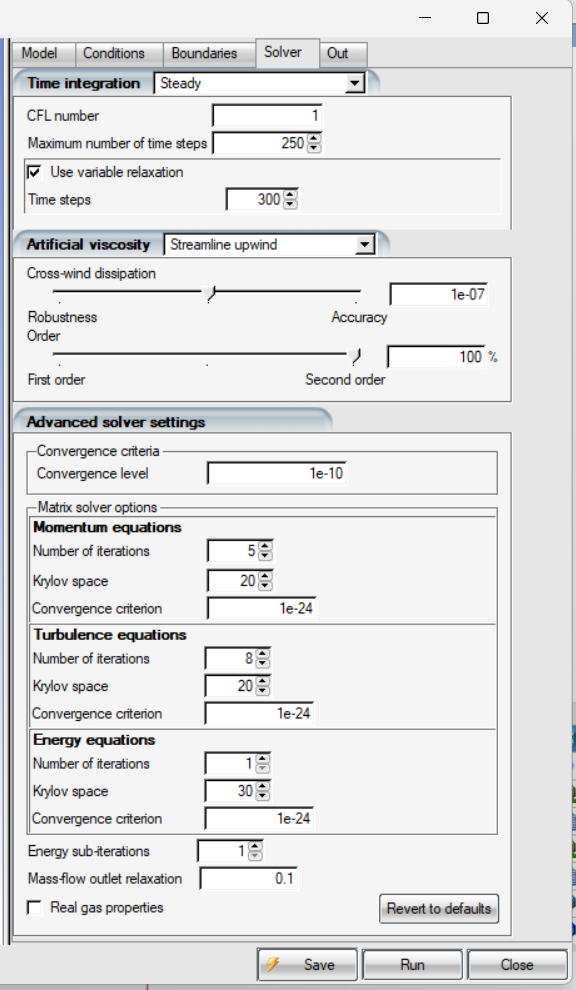

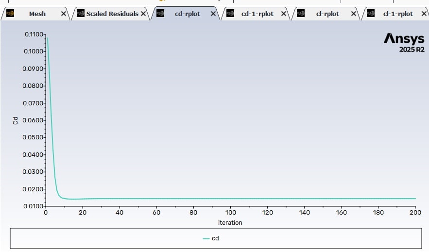

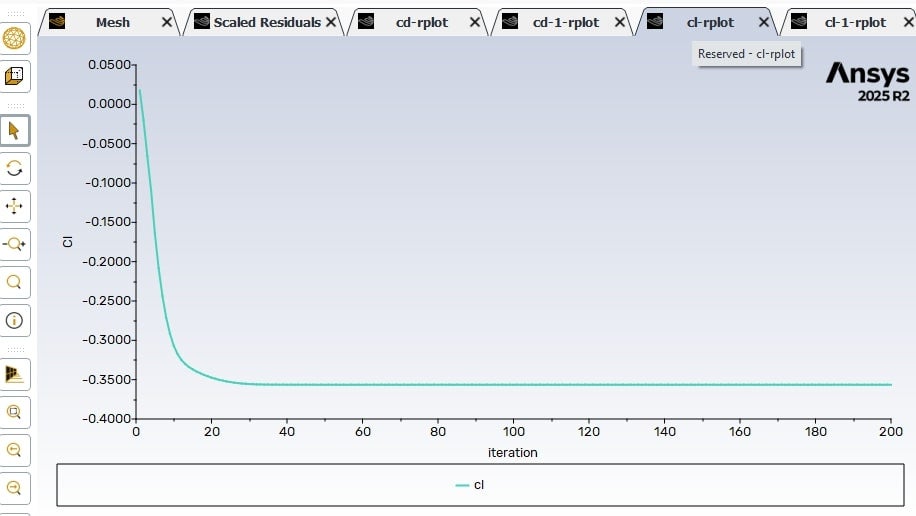

      i am doing an icing envelope for a custom wing and i am creating a mesh in fluent and then exporting to fensap; however the mesh is converging fine in fluent but diverging in fensap, even with cfl=1;(images)
      I am trying to do this on fensap to have better control of multishot sequence and parameters like AOA and different speeds, LWC and temperature;
      I have double checked the BC and don't know what the problem may be; My current mesh has min orthogonal of 0.1 and max skewness of 0.89; I have changed from velocity inlet/pressureoutlet to pressure far field and on both I even have close enough Cl and Cd but both diverge once I go to fensap; also tried changing from SA(which I intended to use) to kw-sst to no result.
      Is it something with the mesh? or am I messing up the setup somehow? what should I do?

      Is the Fensap model failing for flow only, or with the icing model(s) on?

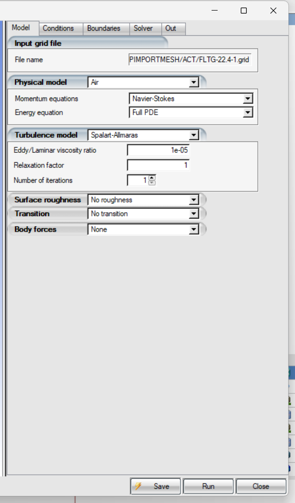

        This is the setup i’m using; i also i have variable relaxation on the fensap airflow setup and adaptive time step but no progress; i managed to improve mesh quality to min orthogonal 0.15 and 0.86 max skewness but no convergence still; I’m using this because i want to use different design points and dont want to manually import restart files on the ice setup if i use fluent to solve airflow and fensap for the rest. @Rob

      Failing for flow only; only ran droplets and ice once and was using airflowimport from the fluent run and both ran fine and converged.

      Hi, I’m still trying to fully understand the objective here. Workbench does have some limitations, and I wasn’t able to see the geometry or the FENSAP settings, which makes it a bit harder for me to help troubleshoot the convergence issue.
      If the case is already working in Fluent, could you help clarify the need for running an additional airflow case in FENSAP? Both Stand-alone (outside of Workbench) FENSAP-ICE and Fluent-Icing support multishot cases with ALE and automatic remeshing. Also, Fluent Icing has some advanced capabilities that allow parametric studies to be run within a single environment. Do you have an academic license? A great set of tutorials are available on the help page. I would strongly encourage to look at these for both FENSAP-ICE and Fluent Icing.

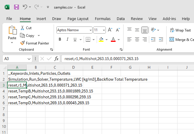

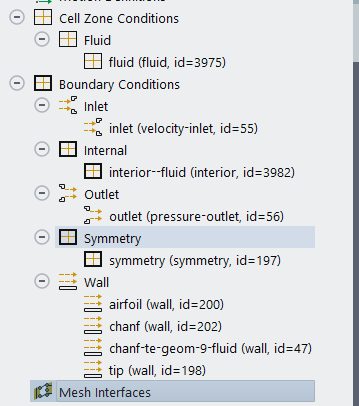

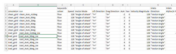

        Since your last message i tried using more of fluent-icing but I'm having problems with the remeshing, after running the case for the first shot the remeshing log shows a "periodic" BC that doesnt exist and the remeshing fails to recognize BCs as they were before. I cannot show the wing due to NDA, but I have access to a teaching/research license. These are my BC and cell zones and the fensap settings i had before. Another question is regardin the csv for serial runs, i tried a couple of times using the same format of the worksapaces tutorial but it gave me errors like "Multishot does not exist in settings solver". I tried ALE displacement and had errors on the second or third shots of my multishot "Mesh morph - ALE : Iterate| Error: problem in call level sync| MSG-ERROR: Error in meshMorph - mesh conformity failed| reading grid ...| Error in solver cleanup: 2| Error: Error in Mesh Update calculation| Error: Error in Mesh Update calculation
      • magnergusse
        @Shoaib Shah @Rob
        Still trying to automate this process and the csv doesnt seem to work no matter what i try i get htese errors and always, neveven if the variable isnt the LWC its always this error for one of the variables
        I managed to get the multishot working even though it still shows the non-existant BC while remeshing; is there a tutorial available for this or for how to create code for this? I am trying with the csv just like the Fluent_Workspaces_Users_Guide 2025R2 section 1.14.7

      I am on business travels this week, but it appears there are issues with the setup. What release version are you on ? For remeshing to work, there are certain recommendations we have outlined in the Fluent Workspace Manula that you must follow, regarding naming and no. of symmetry planes, material point location, z=0 plane requirement etc. Otherwise you get the error as you have mentioned. Also note that those requirements are different in FENSAP-ICE (Multishot with Fluent workflow) to those in Fluent Icing, and so for the former the fensap-ice manual is the reference. Before running, any parametric studies with the csv file, I would ensure that the set up for simulating multishot & single shot icing runs are well understood inlcuding air properties definitions, understanding ice density options (constant vs impact density model), roughness (0.5mm for clean starts vs beading model for remaining shots), no of shots, recording and reuse of python journals (see section on batch runs as well which will help with csv options) etc. I hope this helps, and let us know if anything thank you.

        I managed to get most of the setup done by now and tested a preliminary csv and it worked; now I only have two questions:

        I don't want an AOA sweep, I want to test different atmospheric conditions for a specific speed and AOA, that's why I want to use the csv.

      There is an issue with the custom shot option (beta feature) in Fluent Icing and are we are looking to resolve it. In this case please define the shots for the ice shape only. Once completed you can use the final iced geometry (mesh), to run your aero degradation studies. Please have a look at the Fluent Icing Tutorial and in particular for csv and running sequence, please follow section 1.1.9. Scheduling a Sequence of Runs With Fluent Icing. This also explains how to run iced grids (AoA sweep but not limited to this).

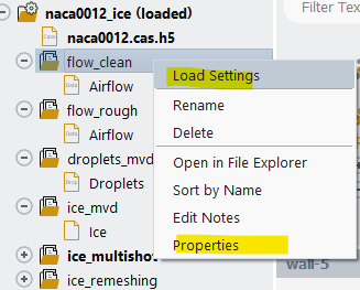

      • For now, you would need to calculate this manually (e.g., in Excel), or directly, i believe, within the CSV file used for the parametric study by specifying the calculated value (or by solving it directly) in the “Wall temperature” column.
      • You can load each run and review the settings as shown. Additionally, there is a run.settings text file within each run directory that can be checked for the setup.
