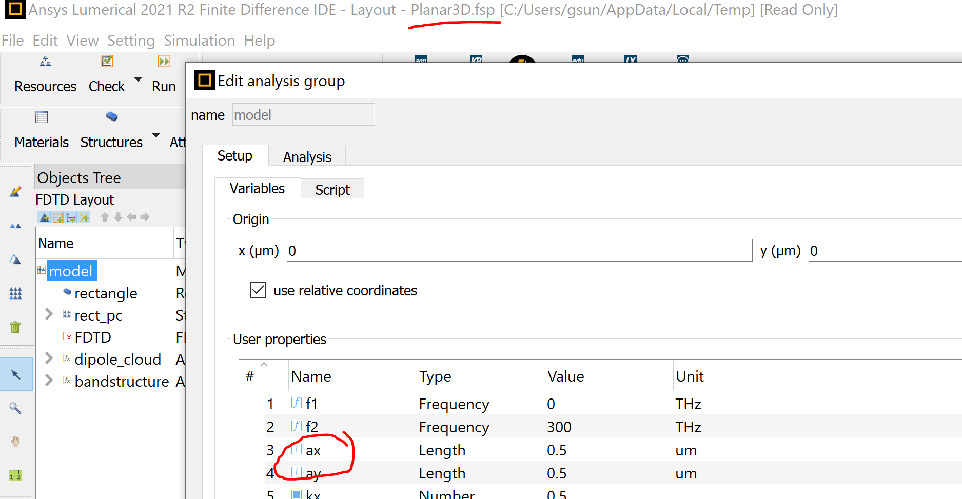

September 17, 2021 at 10:46 pmGuilin Sun
Ansys EmployeeI do not know how did you create your simulation file. If it is from the example, it is lattice dependent. Once you choose rectangle lattice, you can modify to have ax and ay differently. In this example:
Bandstructure of planar photonic crystal with a square lattice you can see it has ax and ay. what you need is to assign them different values.
You can also write your own script in the model to meet your specific requirements.

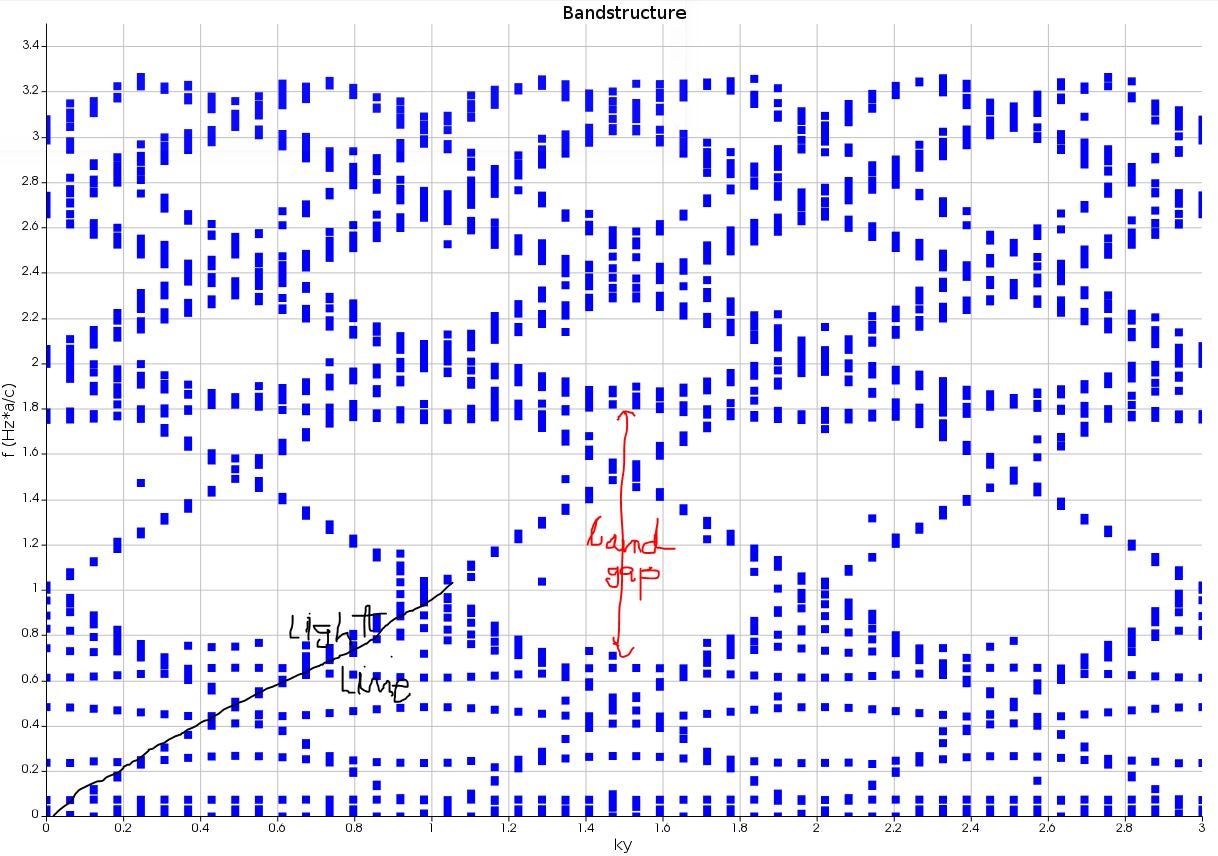

September 20, 2021 at 5:45 amInfinite
SubscriberThank you Mr. gsun.
Following all the information you have provided, this is what I got in attached pic.
So please let me know is the light line and band gap seems to correct.
The question for the metal and dielectric layer structure with periodicity, how can I obtain the dispersion curve from here please?
Thank you for a lot of help.
September 20, 2021 at 4:55 pmGuilin Sun
Ansys EmployeeFor 3D band structure simulations, if the geometry has symmetry, please use symmetry BC to separate TE and TM modes; if there is no symmetry, please set the dipole polarization properly to isolate them. otherwise the bandstrucures are mixed, it can be difficult to extract information correctly.
The light line seems ok but the bandgap seems there but difficult to quantify.
In addition, it seems you simulated more than one period or Ky larger than irreducible Brillouin zone ? please make sure the simulation settings fulfill the requirements.
Once you have correct band structure, you should be able to convert it to dispersion curve, since you have frequency and K values. You may need to find some reference on this.
