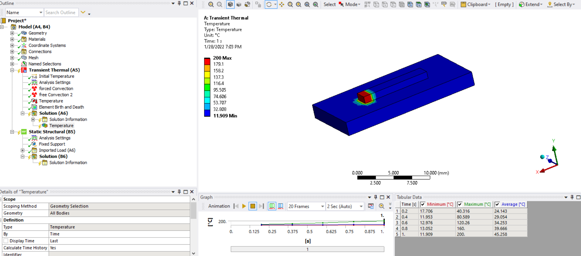

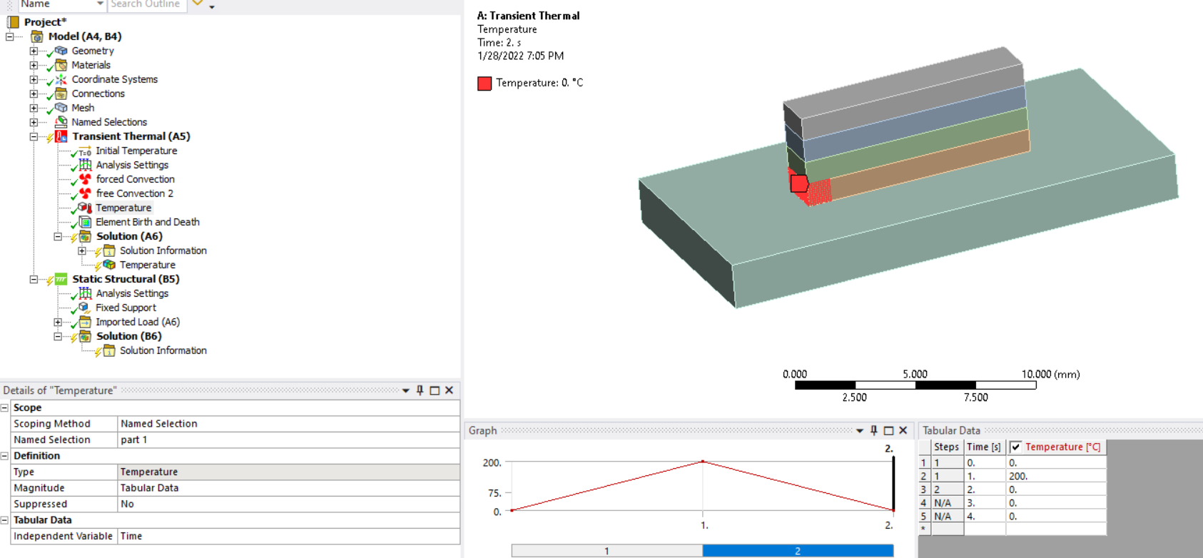

SubscriberHello Ashish First of all, thank you very much for your time and help in answering my question.
Should I need to change the type of the contact (bonded, frictionless, or something ) or will it work as a default contact?
For Element birth and death I was wondering if I can use it manually from the "option"[insert>element birth and death] to avoid the coding part as I had in the tree (I am new to coding).
For number 3, I didn't understand if I should use both temperatures on the face and insert Internal heat generation? Do you mean after adding temperature do I need to do the internal heat generation on the part as well? Because all I know is the filament coming from the nozzle has 200C and the filament eventually going to be a part so I was little confused about it.
I have shared a Youtube video of the 3D printing simulation. I know they have used a lot of APDL on this. Is it possible to do it without coding? I mean manually from workbench

Use bonded contact.
Yes, you can insert the element birth and death manually.
For filament, you know that the surface of filament is at a temperature of 200 degrees Centigrade then you should assign only a temperature to the faces.

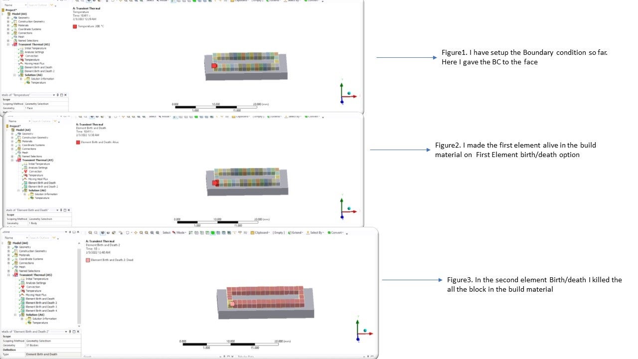

I have created a simple model to run a simulation with a almost 40 different block as a building material sitting on the the base. I have a shared a pic of it
I made it 40 different part because I felt easier to assign different BC separately. (especially when assigning Element Birth/Death). I was wondering if I can make a single block and separate them in 40 different pieces ( 40 diff named selection ) to give them BC separately. Is it possible ? if yes then how ?
Is there a option to make a loop manually for element Birth/death ? do I need to add separately for element birth and death option for separate element? From my guess I was think there is gonna be 80 Element Birth/death on the tree for 40 different blocks.
the rest of the information I have explained in the figure. Can you please have your comment my work if I am doing something wrong.
Appreciated your help Mukesh.

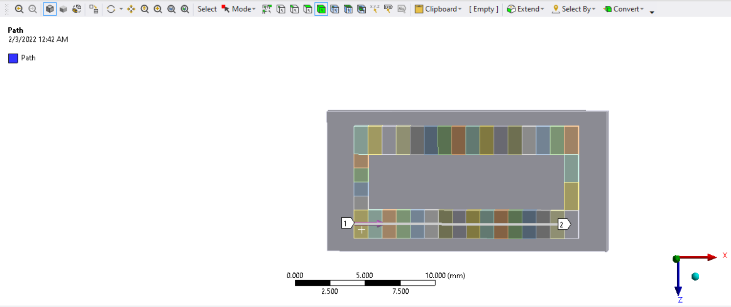

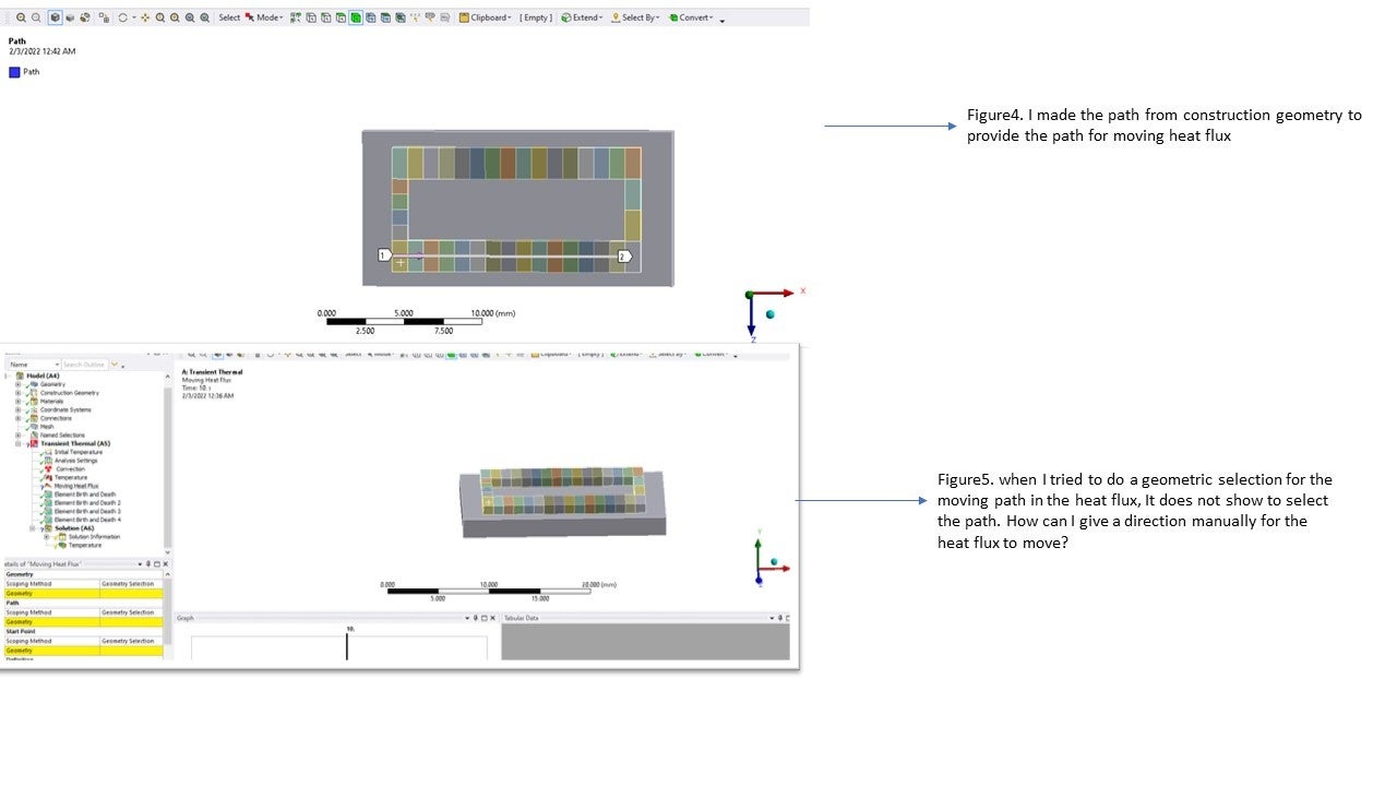

I already downloaded it and I have tried 4-5 tutorial about using heat flux. But the problem I am having with applying heat flux is the path and the starting coordinate. Usually, they had this joint section where they select as a path and but usually i have a block sitting next to each other side by side and when ever I tried to select a path. I don't find a way to setup it like i posted a pic below . I tried to construct a grometric path but it didn't work
