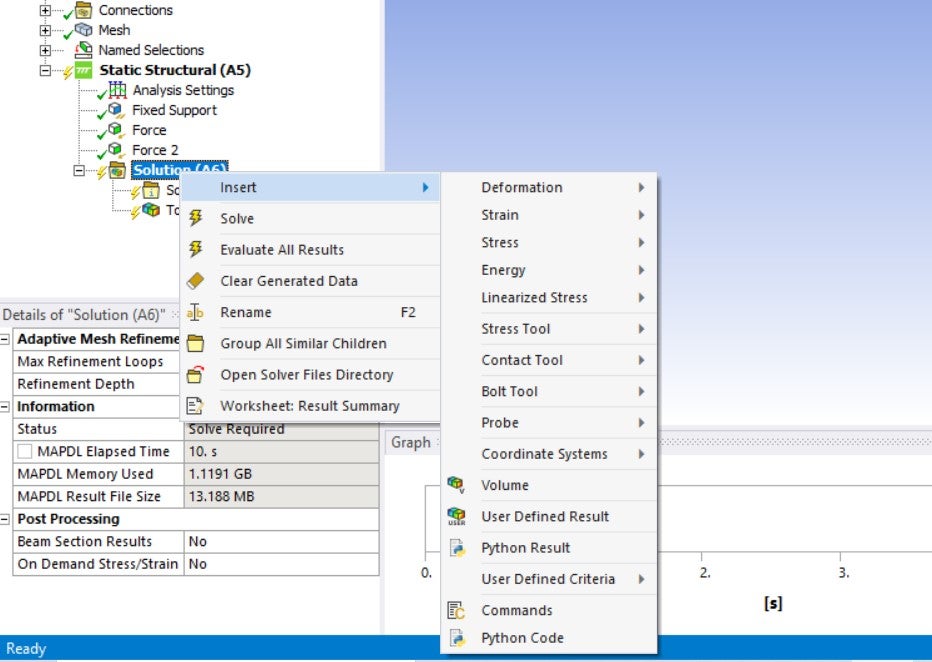

Ansys EmployeeThe Mechanical Fatigue Tool (FT) is not available with all license levels. Where you previously able to access the FT with a Student license?
March 13, 2023 at 6:33 pm
vigneshwaran19119
SubscriberSorry Daniel. I found out that Fatigue tool is not supported with symmetry boundary condition which I had used in the setup. After I removed the symmetry and scaled down my model to meet student license limits, I was able to use the Fatigue tool.
March 13, 2023 at 6:41 pm
danielshaw
Ansys EmployeeYes, you are correct that the FT cannot be used with symmetry boundary conditions. That limitation is documented. Sorry for not mentioning it, but I did not see a Symmetry Condition in the Mechanical Tree. The FT is blocked when the tree has a Symmery Object, because it cannot be used with cyclic symmetry. If you need general symmetry, you can impose a Frictionless Support on the symmetry face rather than using a Symmetry Object. The FT works fine with a Frictionless Support. It is the presence of the Symmetry Object in the tree that blocks access to the FT.
