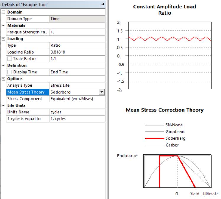

      Hello
      If I have a stress and I want to calculate the fatigue for plus and minus 10% of that stress which is the loading type and settings on fatigue tool to use on Ansys?
      Thanks
      The stress was caused by a load.  If the load magnitude was 1, then the load magnitude that causes a 10% higher stress is 1.1 and the load magnitude that causes a 10% lower stress is 0.9
      Use a Type = Ratio where the Scale Factor is 1.1 and the Loading Ratio is 0.9/1.1 = 0.818181
      You might also consider which mean stress theory to use.
      If this answers your question, please mark the Is Solution link below this post to mark this discussion as Solved, or ask a followup question.
    • dardaem
      Thanks a lot.
      And if I want to calculate the mean and stress amplitude should I use the equivalent or principal stress results?
      Use Equivalent Stress.
