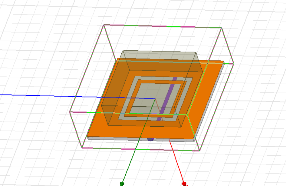

SubscriberWhile I'm Simulating the Square ring slot Coupled DRA i'm getting this error Fast sweep setup, process hf3d: Poor convergence in computing port dispersion.

Ansys EmployeeHello Could you please let us know any specific reason that you are using Fast Sweep?
Poor convergence might result due to incorrect exiction/ geometry, I will recommend changing your frequency sweep to interpolating or discrete.
Please let ins know if you still face the same error after changing the sweep type.
Regards Vivek
