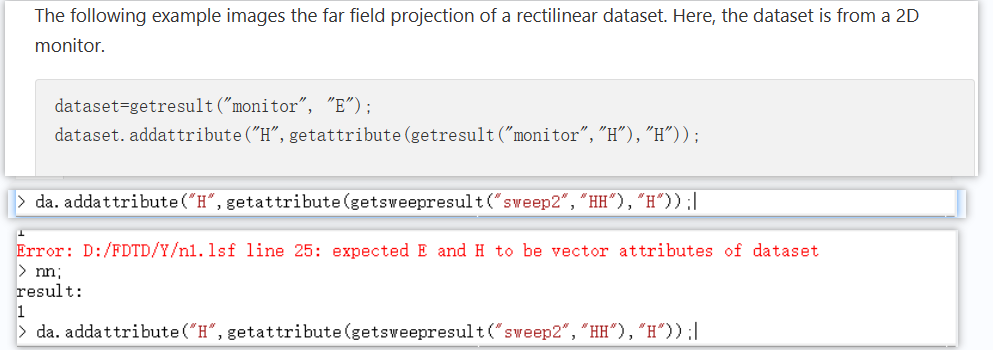

      When projecting the given linear data set to the far field, the code in the middle of the figure is modified according to the example given by the official website ( above the figure ). The middle code is not reported wrong, but it is reported wrong in the last step. Can it be modified to achieve the purpose,thank you.
    • Guilin Sun
      I guess it is because that E dataset is from the monitor, which is a function of xyzf. But HH is from sweepresult, which must have higher dimension than E. Please get H by use of getresult from the monitor.
