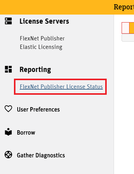

    • George Karnos
      a -4 means that all of the SpaceClaim licenses are checked out by users.
      Are you connecting through VPN through the WIFI?
      When connected through WIFI, run the ANSYS Client Licensing settings and choose
      Flexnet Publisher License Status
      Post the status. Do not attach a file as we are not permitted to open them.

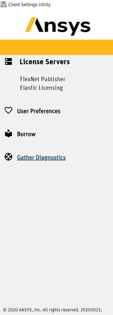

    • dimitri.hamelin
      thank you for your answer.
      Yes I use a VPN but I have already used ANSYS with this vpn before.
      Sorry, I only have this (cf photo).
    • George Karnos
      While on VPN:
      Run Gather Diagnostics in the Client Licensing Settings Utility
      This will create a directory and display it in the window.
      Under that directory, you will see a file named:
      diagnosticInfoScreenOutput.txt
      Open this file with Notepad
      Look for the following:
      Getting available license information:
      Below this will be the License Status
      Post the output, please
      Thanks!
