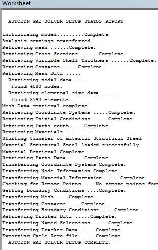

      Hi everyone, I am trying to run a model using Explicit Dynamics AUTODYN. It was okay before but suddenly I can't run my ANSYS using Explicit Dynamics AUTODYN anymore. I have already reinstalled the program a couple times but it still does not work. This is the preview of the "solution information" and "RSM"
      Explicit Dynamic Solution InformationRSM
      This is the second time I faced this problem. I manage to solve it on other computer by reinstalling and delete all of the ANSYS model inside my computer. I tried to do the same on the other computer but it did not work.

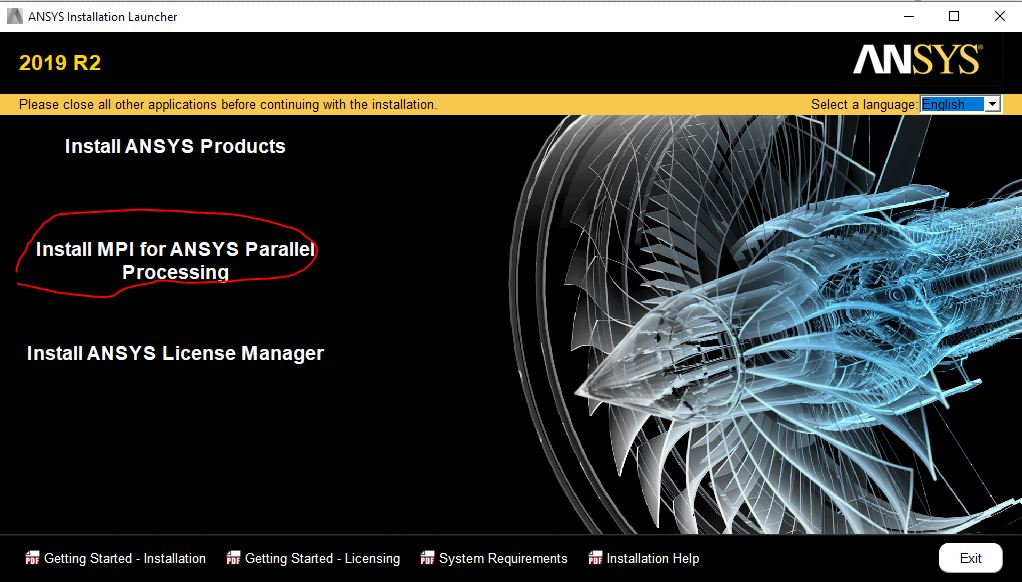

      Sorry for the late response. Just checking when you do the installation, have you installed the MPI?

      Hi Wenlong,
      Thank you so much for your time and responses.
      I did not install the MPI though, is it necessary? Because previously I can run my ANSYS just fine before.

       Stuck on
      Is it possible that the problem is on the Explicit Dynamic AUTODYN License?
      Because in my different computer, after the "AUTODYN PRE-SOLVER SETUP COMPLETE." appears, usually it says license acquired or something like that. But this time it can not get the license, thus it won't continue the process.

      Don't install the extra MPI.
