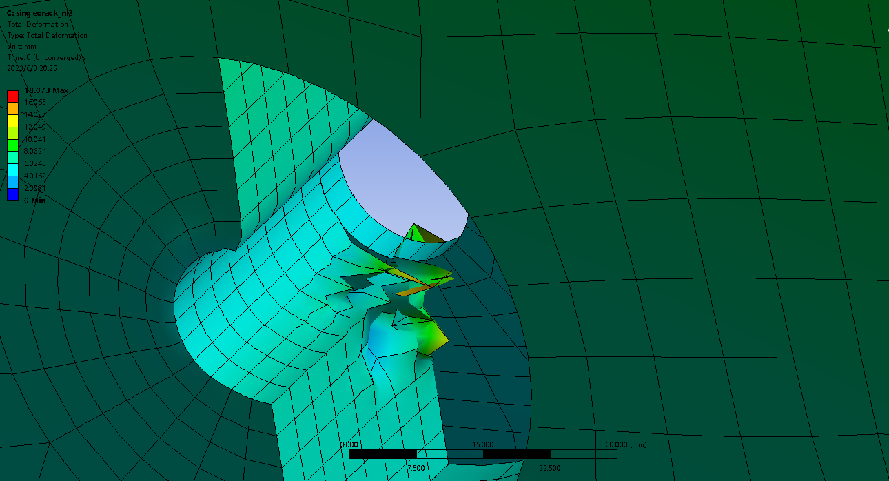

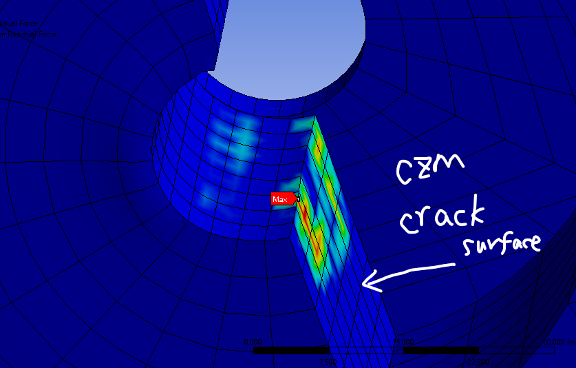

SubscriberHi SaiD, May I ask a question? In my static strutural model using ANISO material, one of the contact regions is for debonding cohesize zone model and I found out high newton raphson residuals in there. Do I also need to reduce the normal contact stiffness? I am confused that the normal contact stiffness is for closing the contact or openning the contact? If for both, that makes more sense. I also saw highly distorted element at this location. Should i refine the mesh anyway? Because I think the mesh is fine already.
Thank you for your help!
