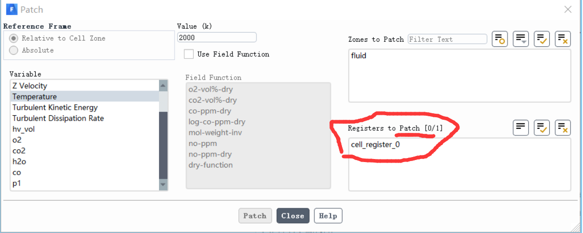

I am faced with the problem to choose the register in the The Patch Dialog Box with TUI Commands.
I tend to change the the value of the temperature from 0 K to 2000 K
and the TUI command "/solve/patch/ _ cell_register_0 _ temperature n 2000" is used
however, I failed to choose the register :
Is anything wrong with my command?
or should I add another command?
(Ansys 2020 R1)
August 30, 2021 at 3:29 pmRahul Kumar
Ansys EmployeeHello,
Use /solve/patch () (cell_register_0) temperature 2000
