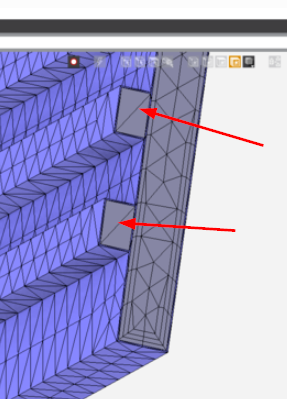

Naresh Patre
Ansys EmployeeHello Bhaskar Thanks for sharing the image. As I suspected, the mesh is very coarse. You can see only 2 elements across the thickness as well as in the rectangular section highlighted below.There should be a minimum of 3 mesh elements so that the tetra mesh gets successfully converted to poly mesh. Please refine the mesh using global and/or local settings. You can check the AIM examples posted on this forum and check out the mesh generated in those models to get an understanding.

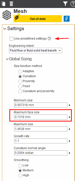

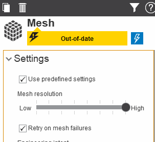

Naresh Patre
Ansys EmployeeHello Bhaskar First, you can try increasing the mesh resolution by moving the slider shown below to the extreme right.If this doesn't help to refine the mesh, deselect the option "Use predefine settings". This will allow you to manually specify the mesh sizes. Under Global sizing, set the Maximum face size as 1/3rd of the thickness.

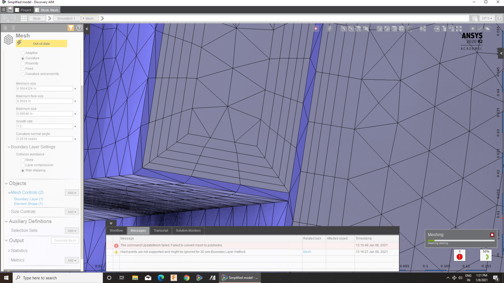

January 8, 2021 at 2:53 pm
BhaskarModak
Subscriber-
January 20, 2021 at 9:31 am
Naresh Patre
Ansys EmployeeBhaskarÂ
Can you try reducing the boundary layer count from 5 to 3 and regenerate the mesh? You can find the Boundary layer settings under Mech Controls
