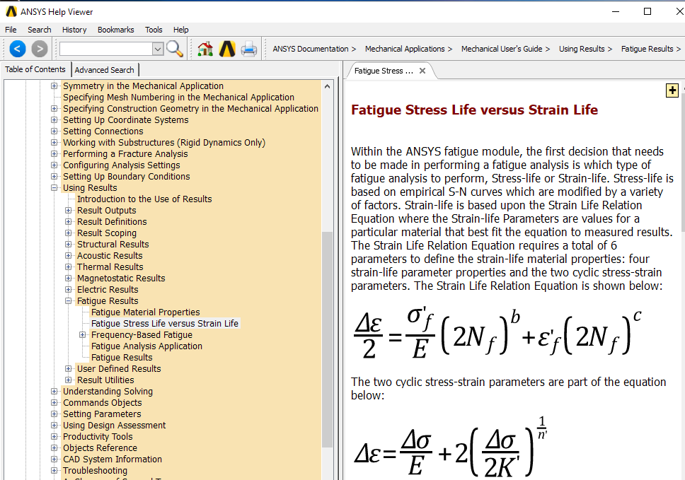

      I have been running a process in ansys and I get the results. However, I need to see which formulas ANSYS used. I want to see the formulas that ANSYS uses to compare an analitical approach. Could you please answer me if there is a way to see those formulas?

      Open the ANSYS Help Manual, go to the Mechanical APDL section and look in the Theory Manual.
      What is the analytical equation you are using?
    • halilkimsesiz
      I am using SWT method for low cycle fatigue life condition. Thank you :)
      Did you find this page in the Help? You must first open the ANSYS help, then you can copy/paste the URL below into the browser that is running ANSYS Help.
      https://ansyshelp.ansys.com/account/secured?returnurl=/Views/Secured/corp/v212/en/wb_sim/ds_Fatigue_stress_strain.html
      That page has the Strain-Life equation.

      What version of ANSYS are you using?
      Old versions of ANSYS had their own help viewer pointing to a local copy.
      New versions of ANSYS use the online help version linked to in the URL I provided.
    • halilkimsesiz
      I am using Workbench 15/ Is it also possible to see of the formulas for factor of safety under fatigue life calculation?
      Here is a screen snapshot from ANSYS 18.2 and I expect 15 might have the same section in the help.
