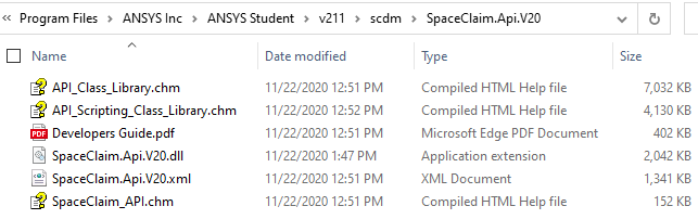

July 20, 2021 at 5:24 pmPeteRimkus
SubscriberI downloaded and installed the Student Version but apparently I cannot read the API Docs without registering and I cannot register without a Customer number.
July 21, 2021 at 12:28 ampeteroznewman
SubscriberThe files I showed above are installed with the Student version. They are on your drive. I opened the .pdf file and the .chm file as well. It's not apparent to me that you need a Customer number.
July 21, 2021 at 11:16 amPeteRimkus
SubscriberThanks ... That was not obvious so I appreciate the help.
The Developers Guide gives me lots of information about developing an addin in SpaceClaim. That is not what I am trying to do, but I will look further to see if there's more there than I noticed.
Thanks again
Pete
