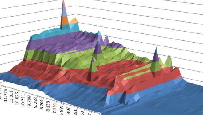

SubscriberHi, I am Jimmy. I have gotten the pressure deviation result for a boundary, I can show them via cfx post contour. I would like to show this pressure result by excel 3D plot. can I use CFX post to do this directly? I found way to extract the pressure result to csv file which can be open by excel. but the pressure result was very very large, it should be depended on mesh I suppose. so it is very hard to draw 3D plot. Give me some advice. Thank you!

SubscriberOkay Jimmy, Excel is not capable of making a surface plot unless the data is on a rectangular grid, which you don't have due to the curved edges of the hole in the center. You can purchase an add-in that has this capability.
A more powerful program like matlab can make a 3D surface plot from x,y,z data, however, you will have to create a surface in the center, put a mesh on that surface and assign values to those nodes. Otherwise, the plotting algorithm will fill the hole in the center by interpolation of the data at the edges of the hole and that won't look pretty.
Why would you expend so much effort to make a 3D surface plot when the same information is conveyed by the contour plot? I don't understand the benefit.

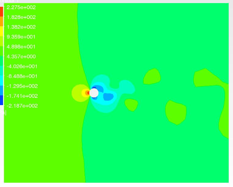

SubscriberAs @peteroznewman pointed out, why would you need a 3D surface plot when contours provide you the same data. And for your case since you have flow over a oval cylinder, the max pressure (at stagnation point) will cause a sharp bump in the 3D surface plot. And as peteroznewman mentioned,for the hole in the center, the data would be interpolated based on the data from the edges. See attached figures for contour and 3D surface plot (matlab) for a case of flow over a cylinder:

SubscriberAny data you export from the plane of interest is going to be missing values at the empty/void region (oval section in your case). And for a surface plot, you need a uniform rectangular grid. So no matter which code you run (Matlab, Excel with the additonal addin, Origin etc.), the value of the exported data in the empty region will be interpolated based on the values at the edges of the empty region. I hope that helps!
