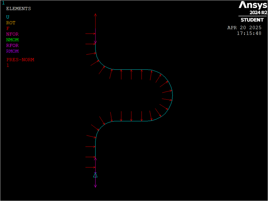

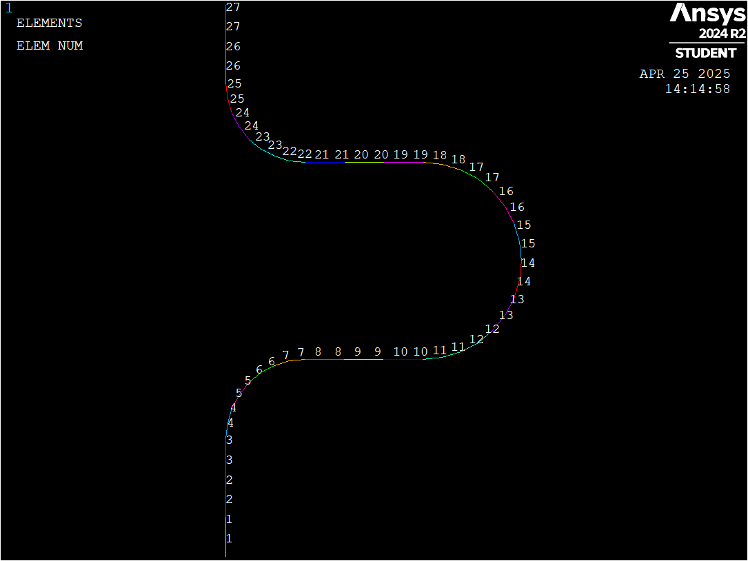

SubscriberI have an APDL input file that has SHELL209 elements that I can see in the Mechanical APDL classic GUI.
This is an axisymmetric model with a pressure load and a Y constraint at the bottom.
I can solve it and plot deformation results.

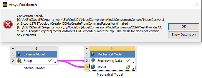

I want to import this model into Workbench and view it in Mechanical. In APDL, I used CDWRITE,DB to create a .cdb file.
In Workbench I added an External Model and pointed to the .cdb file. I dropped a Mechanical model on that and got this error.
I noticed is that the Properties for the Model cell had Analysis Type set to 3D but I get the same error after setting it to Analysis Type 2D. Is there something I can change to make this work?
Here is the APDL input file:
/PREP7
/COM Units are mm, N, MPa
ANTYPE,STATIC
ET,1,SHELL209
SECTYPE,1,SHELL
SECDATA,0.8
SECNUM,1
MP,EX,1,71000
MP,NUXY,1,.33
K,1,10,0
K,2,10,3
K,3,12,5
K,4,15,5
K,5,15,10
K,6,12,10
K,7,10,12
K,8,10,14
K,9,17.5,7.5
L,1,2
LARC,2,3,4,2.0
L,3,4
LARC,4,9,5,2.5
LARC,9,5,4,2.5
L,5,6
LARC,6,7,5,2.0
L,7,8
LESIZE,ALL,1.0
LMESH,ALL
D,1,UY,,,,,ROTZ
F,52,FY,314.159
SFE,ALL,1,PRES,,1.0
FINISH
/SOLU
OUTPR,ALL,1
SOLVE
FINISH -

Ansys EmployeeHi
Do not think these type of 2D line axissym.elements are supported inside wb mechanical (indicated also by error msg) – thus use 2D elements like plane182/183 which are.
All the best
Erik
