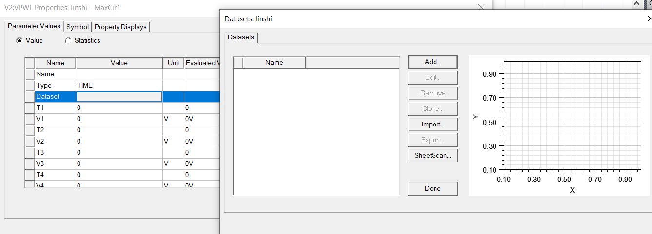

      Can I give voltage exciation from a dataset when working in ansys maxwell external circuit. I think it would be a false statement if I type pwl_periodic (ds_1, Time) instead of Va. Va max refers to the voltage (for sin voltage source). Is it possible what I want to do and how can I do this?

      Hi, ,nInstead of using Vsin, you can use VPWL. Then click add-->import or add. See the attached screenshot.nn
    • johnfides
      Thank you so much icellb, it helped me a lot.n
