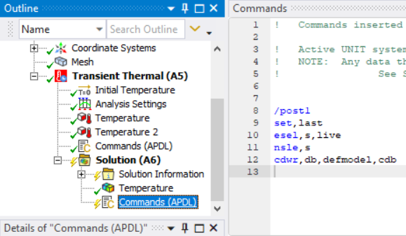

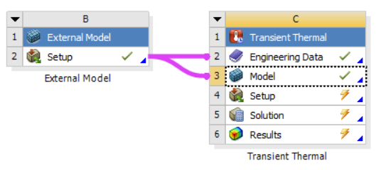

      Including the eroded areas is the same as the original mesh. Just link model cell to a new analysis system. If you want to mark eroded areas, you’ll have to use APDL commands to select ekilled elements (ESEL,S,LIVE then ESEL,INVE) and place into an element component (CM command). Export the cdb (cdwr,db,model,cdb) and read the model.cdb using an External Model system:
      For excluding the ekilled elements, you can use a commmand snippet that selects everything but the ekilled elements and then write the cdb. Then read in using an External Model system.

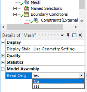

      This will use the same mesh in the downstream system, minus the ekilled elements. If you want to remesh, set “Read Only” to NO on the Mesh object in the Outline:
      ”Clear Generated Data” on the mesh to mark for remeshing. Or setting any new mesh controls or element size values will mark the mesh out of date.
