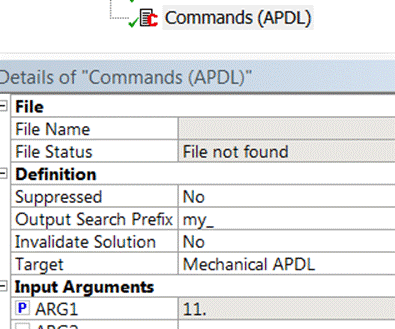

      Used input argument as shown,
      Example, I set ARG1 as 11 in this example
      Inline image 1

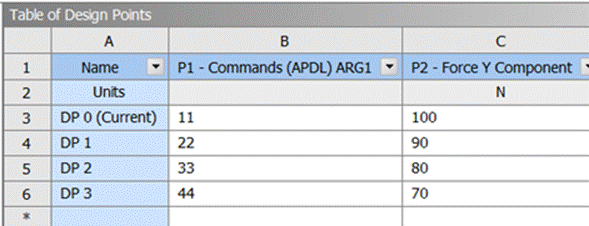

      ARG1 in table of design point. You can use a different value for each design point and you can use this in the folder name or file name

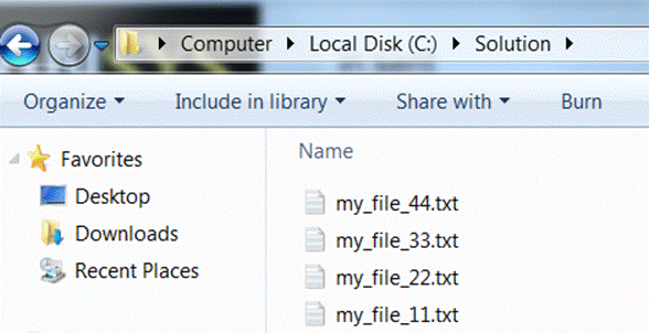

      To send text files in requested folder, in cfopen command, use the ARG1
      Example:
      *cfopen,C:\Solution\my_file_%ARG1%,txt,''    !here ARG1 is used in file name. See if you can use it for folder name
      Inline image 3
