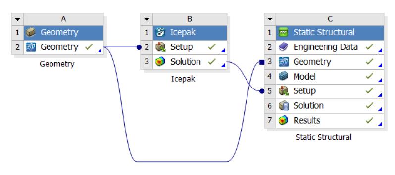

      See image for the correct workflow. Start with the STEP file you have. Convert it Icepak compatible objects in DesignModeler or SpaceClaim. Solve the thermal part in Icepak and then connect it to Mechanical for the stress analysis.
