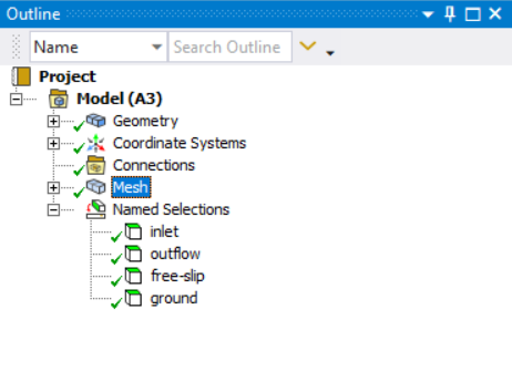

      Can you post an image of the boundary list? That may help see what/if the problem is.
      Unless you really want to mesh the building thickness you don't. In Fluent for thermal models we can assign a wall thickness for conduction modelling: read up on the wall options in the Fluent User's Guide and specifically "coupled" walls.
    • NimaNZ
      The boundary list is correct, and it is uniform. But after struggling with many cases I realized there should be something wrong with the mesh. Then I ran a case with GAMBIT mesh, the streamlines show correct flow structures, however, the mesh generated by Ansys meshing doesn't give the correct flow structures. The mesh generated by ICEM CFD seems perfect as it gives the minimum orthogonality of 1 and the boundaries are uniform.

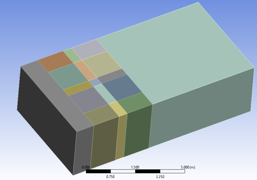

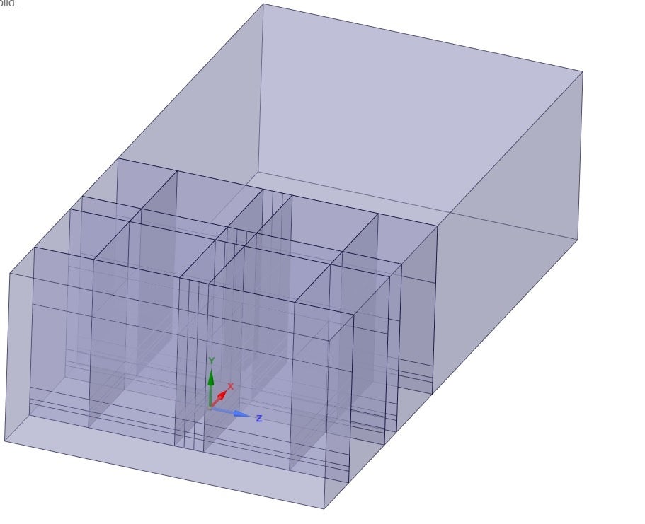

      This is how I divided the domain into subdomains in Spaceclaim to be able to assign the edge side to the edges to generate the structured mesh. I also use the Multizone method to generate the hex mesh. First of all, although all the domain has been divided into parallel lines, the multizone method doesn't generate the 100% orthogonal grid, like ICEM or GAMBIT.
      Then as you can see each surface has been divided into smaller surfaces; in the boundary condition it shows uniform surfaces but when I go to mesh view, the surfaces are a mess. ICEM makes everything uniform once you convert the mesh to unstructured mesh but in Ansys meshing, I don't know how to make it.

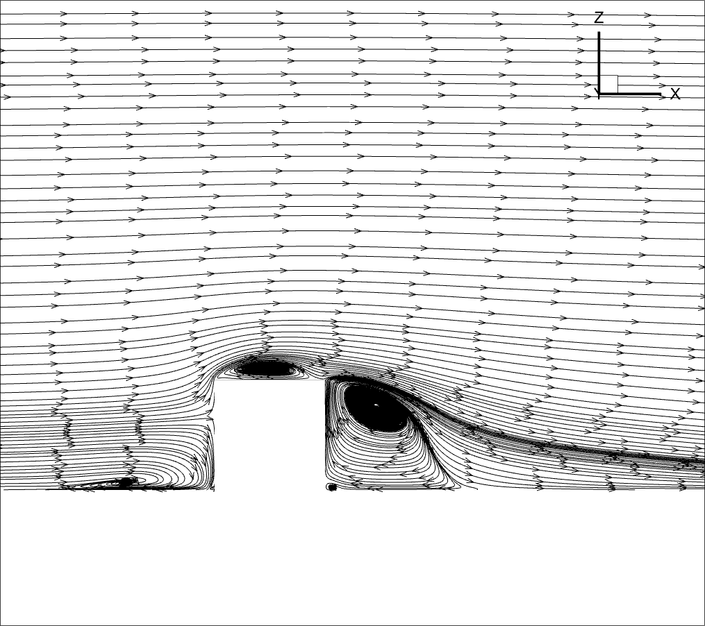

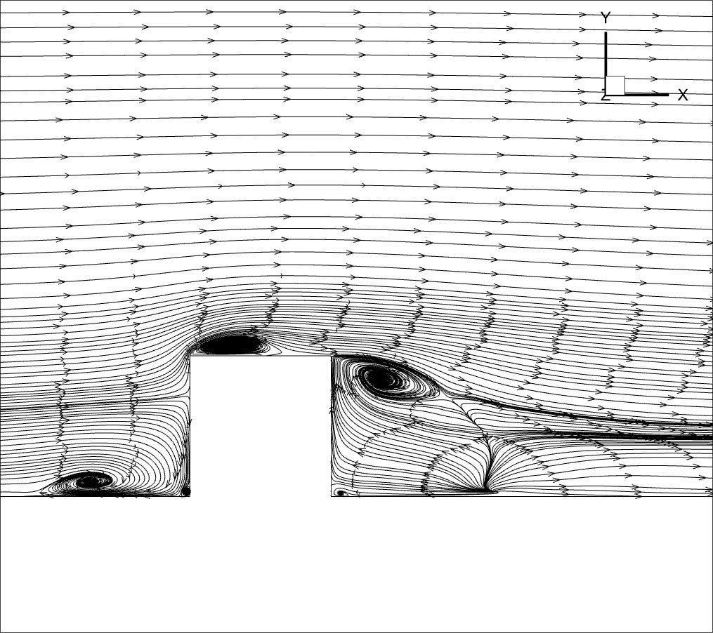

      I don't know what do you mean by results, but here is the difference between streamlines
      with the blocking mesh in Ansys meshing:
      with the mesh generated by GAMBIT Obviously, the second one is correct and agrees with the experiments.
      How do the velocity vectors and contours of velocity and pressure compare? The recirculation zone looks odd in the first image, but pathlines alone can't diagnose a problem. How was the convergence plot in each case?
