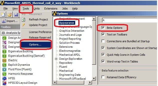

3) In ANSYS Workbench, enable "beta" options in (under Tools > Options > Appearance and scroll down to check box)
