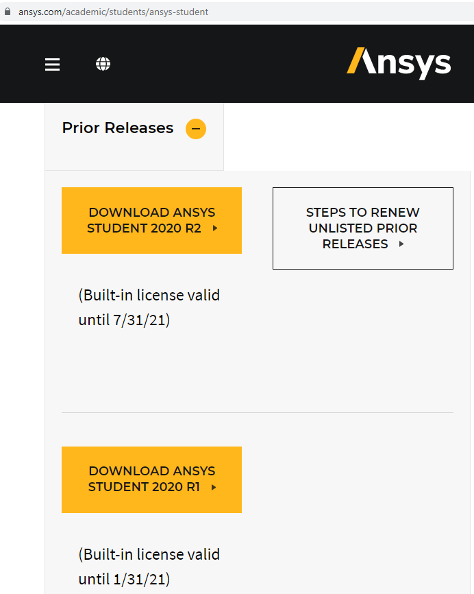

The image below is the SpaceClaim 2020 R1 and R2 Save as type list. It seems like ANSYS has removed the ability to Save As a long list of other types in 2021 R1. You can still download 2020 R2 version. Maybe you should consider installing the older version.

Subscriber.I wanted to get a previous version you have to look down on active download page

I cannot seem to find the 2020 version on the ANSYS website. Would it be possible to guide me to the previous versions of ANSYS (2020 version if possible).

ANSYS Student 2020 is no longer available. You can't export your geometry from SpaceClaim (Student) as an STL file.
Move your .scdoc file to a computer with a full license of ANSYS 2022 and on that computer you can export an STL file.
