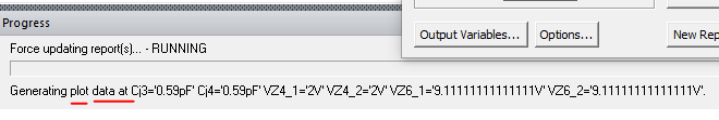

      Hi, its anyway to do that without "pre-rendering" the table?
      For 10k sweeps isn´t a solution. I think ANSYS treats the table as a "plot data". (Image is the progress for creating: Results -> Blablabla -> Data Table)
      Any clue how to export this results without using "reports" ?
