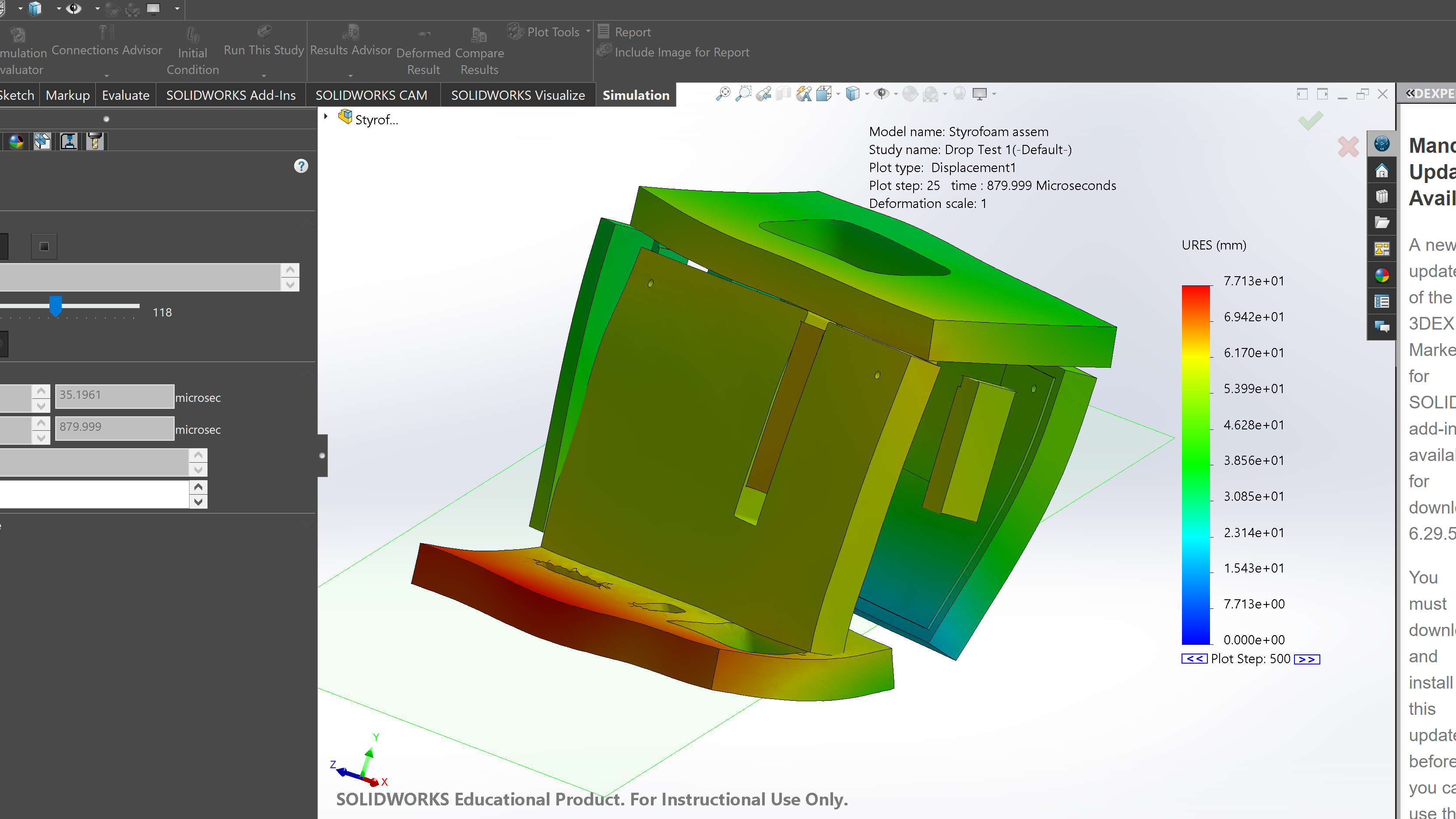

      hello Array , I kept the end time size as 1e-003. Well, actually I changed it from the default 1e-008 to that on your recommendation. In my case, they are not the same! : ) Still, results are not what I expect to see. Can you please tell me how to decide the end time step size value? And thanks a lot! I deleted the default contacts and implemented the frictionless boundary set option active.
      I am also trying the same simulation using the Solidworks Drop test, which also uses the Explicit time integration method, and the solution time after impact is around 880 microseconds which I obtained depending on the dimensions and material of my model. At the moment, the analysis is 10 hrs in, and at 35%? I know that my mesh is really fine, but I am giving it a shot to see how the results compare in the end, and if deformations show on the model.

      hello Array , and thanks a ton for getting back. Ahh, mass scaling. Oh good to know, I'll figure it out, thanks! The Solidworks simulation was a success but took 1 day, 10hrs to solve. But I'm pretty happy with the results. Having gotten some success, I will carry out simulations in Ansys and then get back ?

      hello ram_gopisetti, for the appropriate non-linear effects I applied the plastic von misses material model and no-penetration contacts to the falling object assembly parts (and not the linear elastic material model) that the large deformations such as dents and breakages get captured ?? From what I learned so far, linear elastic model obeys Hooke's law and deformations would thus be obeyed only until the proportional limit and nothing after. At the moment I am applying sensor points to help capture stresses at custom regions. But here's a snapshot from yesterday. Besides, I am figuring out ANSYS as well and shall revert when I need assistance?

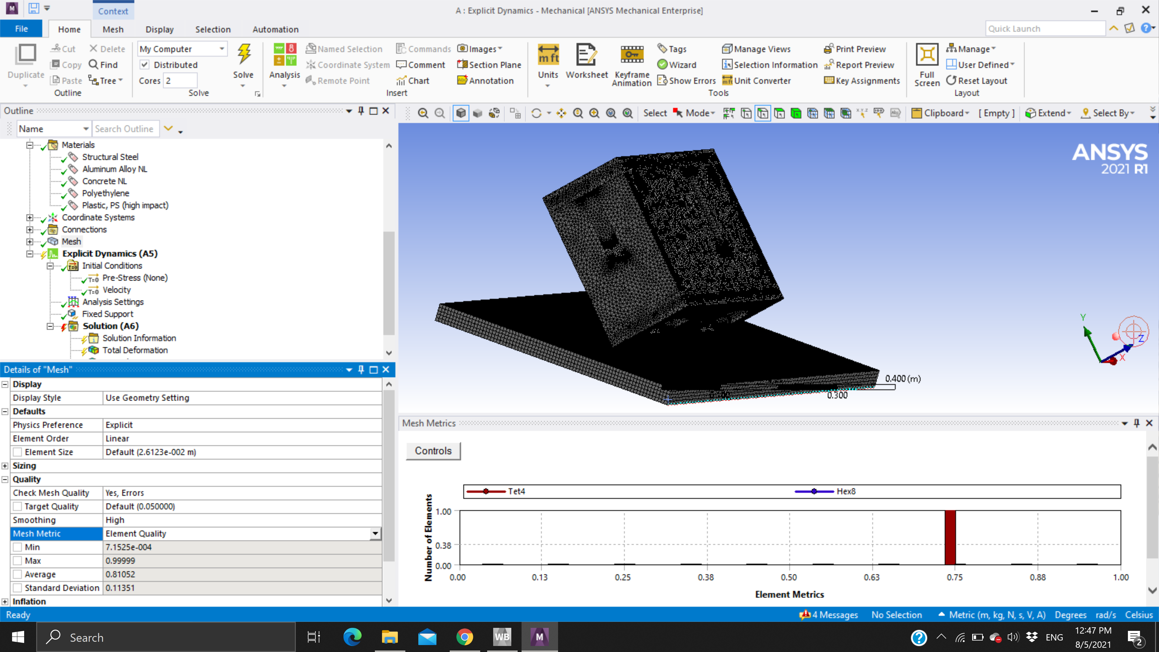

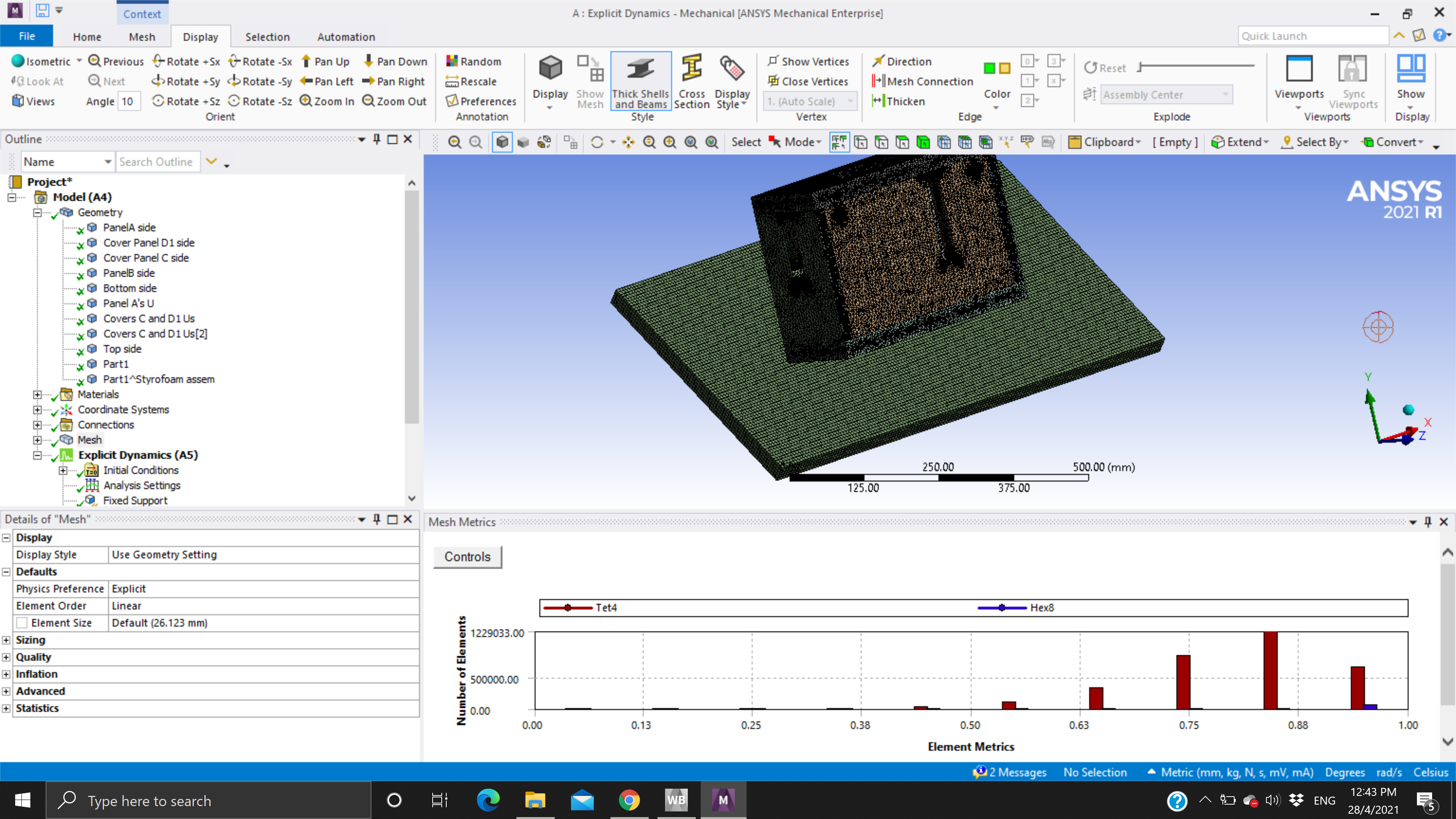

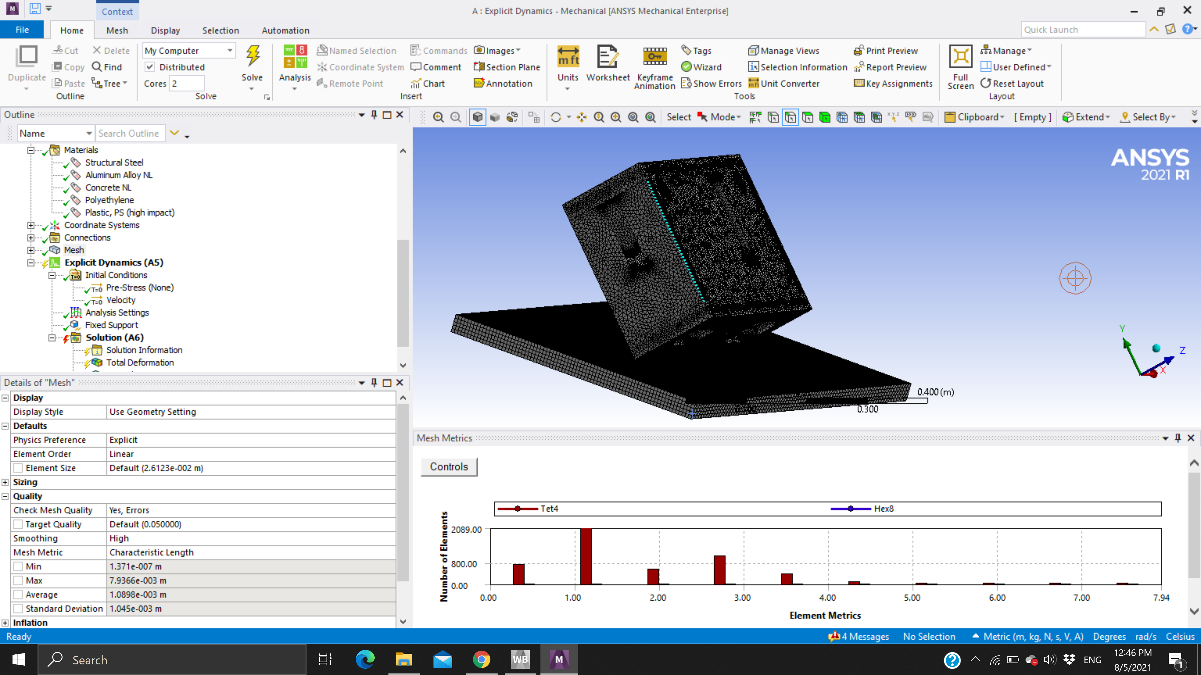

      hello ram_gopisetti , in Ansys I have been getting large energy balance errors and the solutions run very quickly, however, the results obtained are really incorrect. My mesh element quality is as shown below. Is it because I need to eliminate these mesh errors and thus bring mesh quality higher, only then the energy imbalance problem would disappear? What could be the reasons, kind sir? Also, my minimum characteristic length value is really really small as you see
