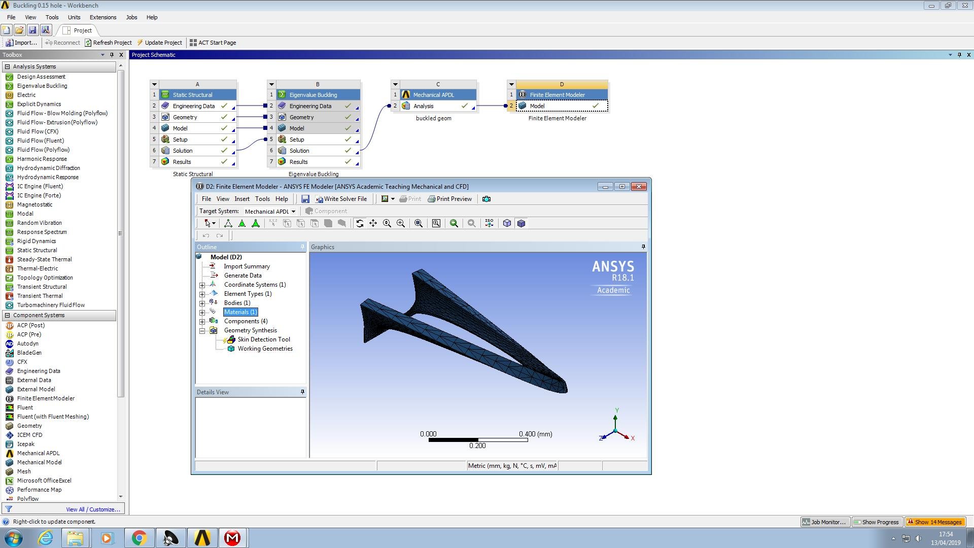

      Hello Sirs, I am experiencing a big problem in non linear buckling:
      When I input the APDL written file as:
      /prep7
      upgeom, , , ,file,rst
      cdwrite,db,file,cdb
      I transfer the data to a FE modeler and obtain always a extremely deformed body, so I cant carry on the non linear analysis.
      can see the image excessively deformed at the right

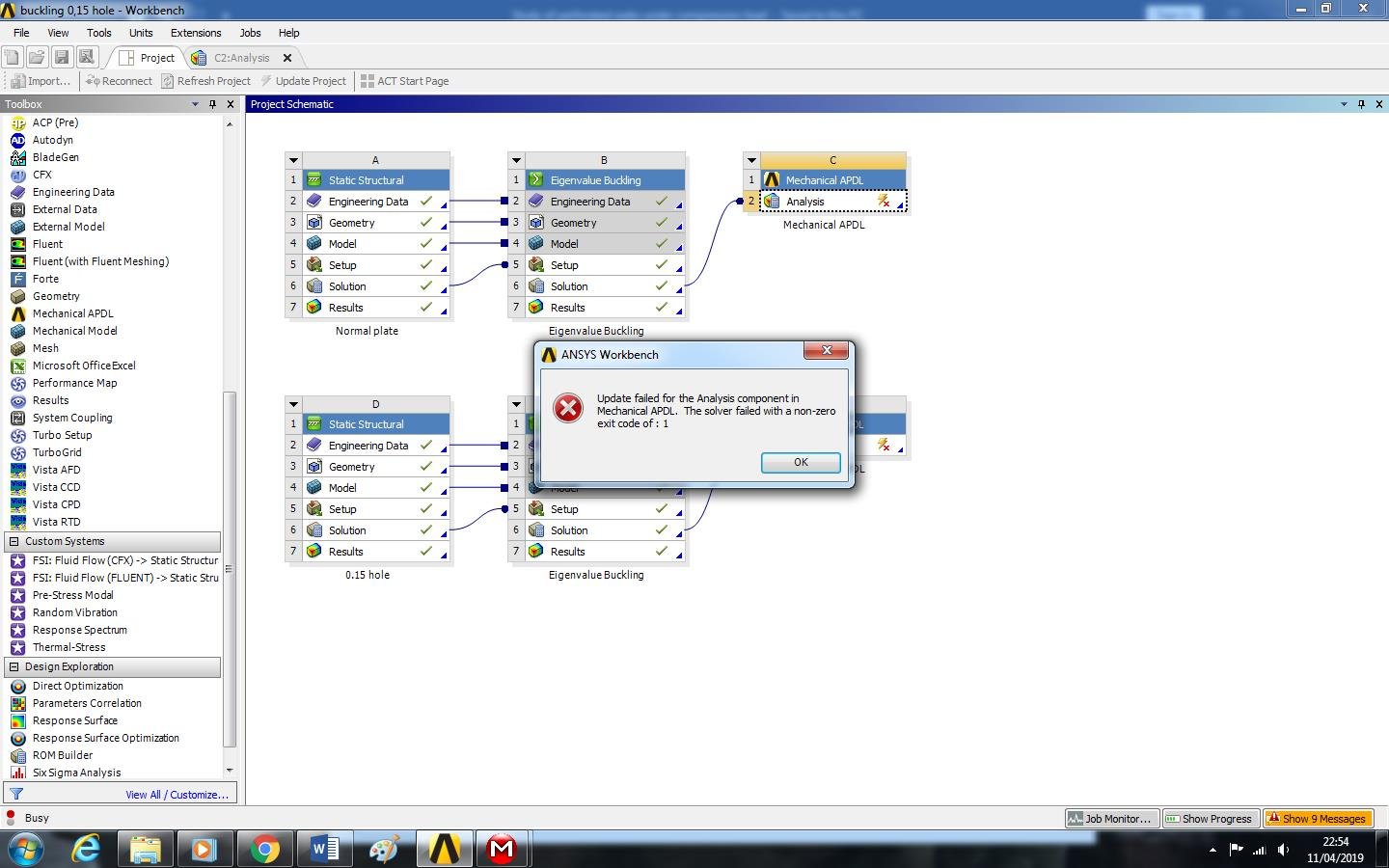

      Also, every time I change the Data on the note pad file (INP file) I have error as answer from the program, I attach also:

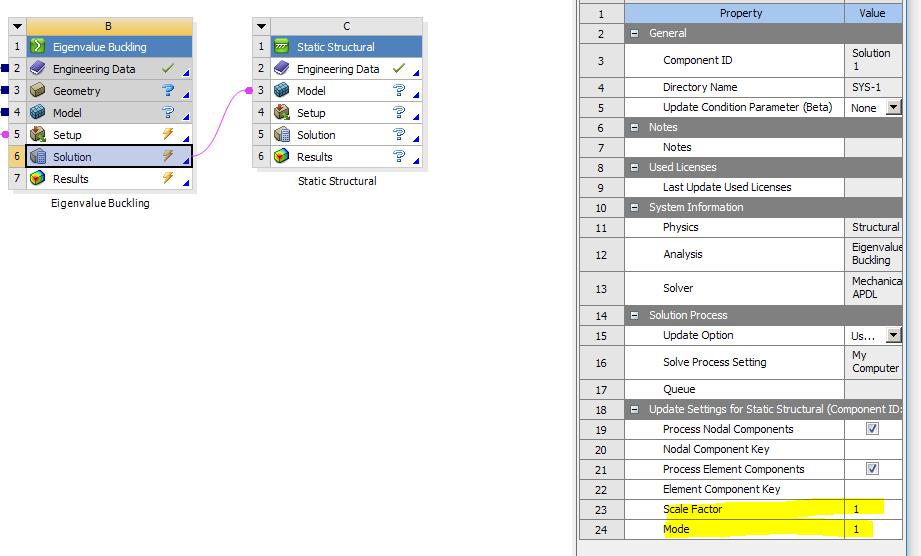

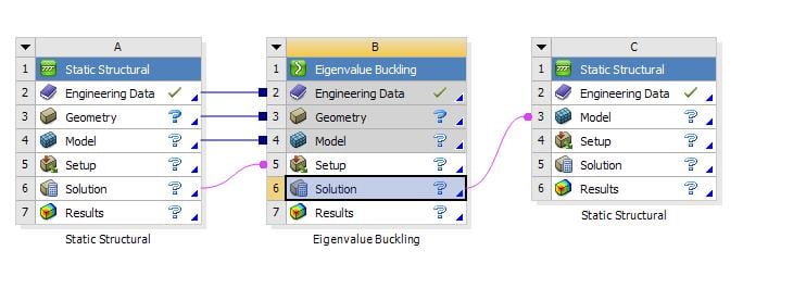

      So, the new workflow for this would look like the below.  Run you eignenvalue buckling, but then pass the solution cell to the model cell of a new static structural that is setup for large deflection, etc. for the non-linear buckling.  This passes the deformed model to mechanical as the starting point for the non-linear buckling (stress free.
      While the upgeom command is historically the way we would solve this, this built in capability is much cleaner.
      You can also pick the solution cell as shown below, and open the properties in workbench and pick the buckling mode and scale factor.  How much initial perturbation is specified can affect the non-linear buckling results so keep in mind you should use something that is physically appropriate, but can bound the buckling load by varying it as needed.
      Sean
