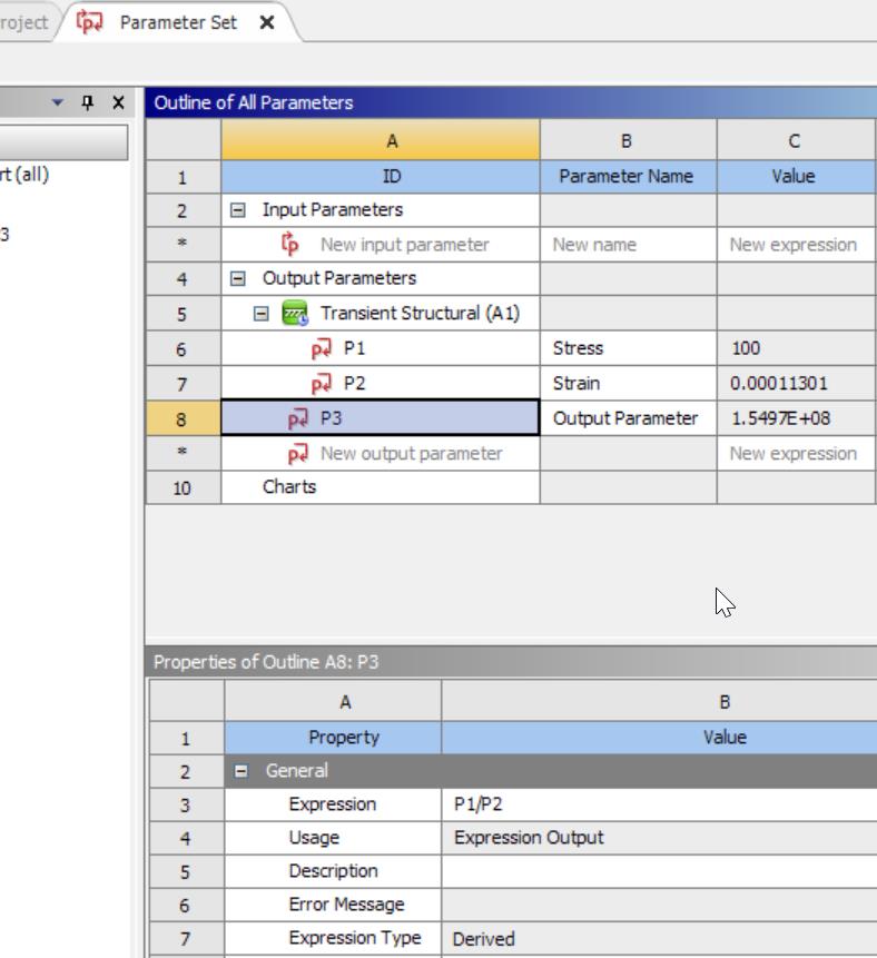

I'm trying to evaluate the young's modulus in the y direction of the lattice structure shown in figure. I set fixed support on the bottom surfaces and I applied a force on the top surfaces. I measured the stress and the strain probe to the top surfaces and I divided them in order to obtain the young's modulus of the entire structure. It returns a reasonable result, but I want to set this result as a parameter in order to optimize it. How can I do it? (I didn't make the division in Ansys, I don't know how can I do this kind of operation).
I use static structural in Ansys 18.0.

Rahul Kumbhar
- The topic ‘Evaluate Young’s modulus of a lattice structure and optimize it’ is closed to new replies.
