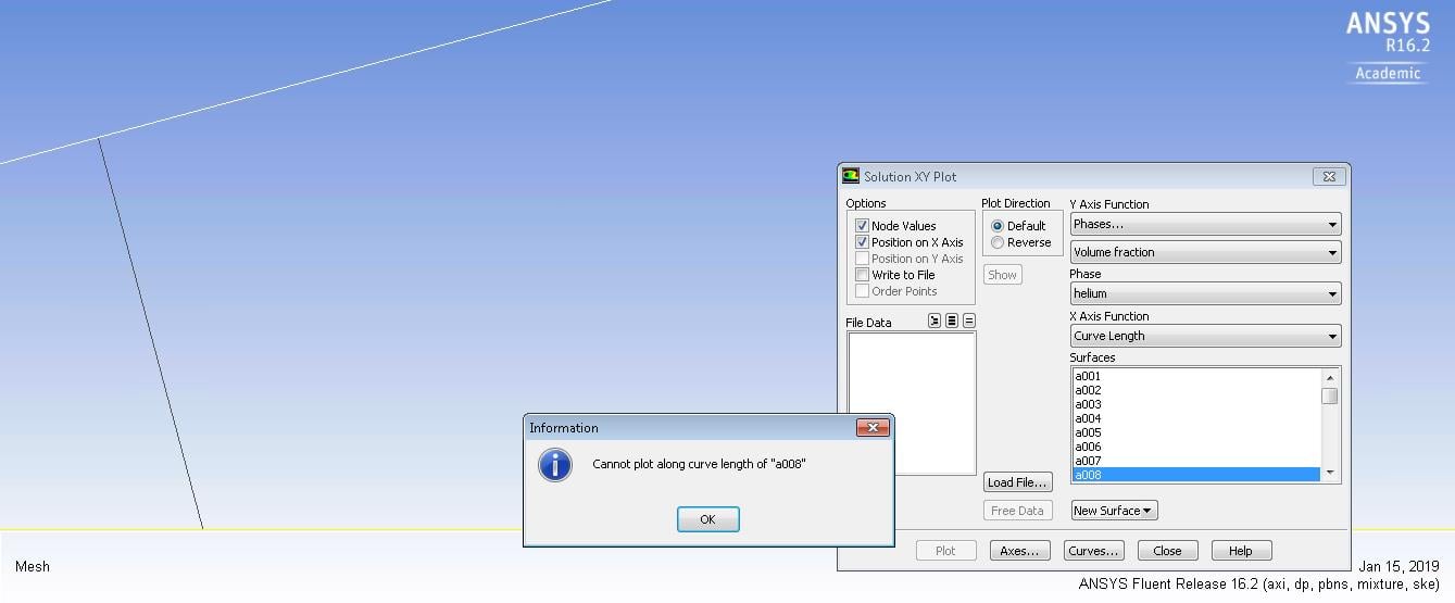

      I'm trying to plot along a created line with Fluent. I created this line with 2 points. If I try to plot I get an error: Cannot plot along curve length .... see screenshot. If i plot with direction vector it strangely works. But I need the plot with curve length.
      One solution is to derive a equation for the curve length depents on the direction vector. But I want to take this solution at last.
      Why I get the error: Cannot plot alonge curve length ...? I get this error for all variables on the Y axis which I tried to plot like volumefraction, velocitiy, ... Does anybody know it?

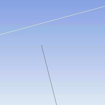

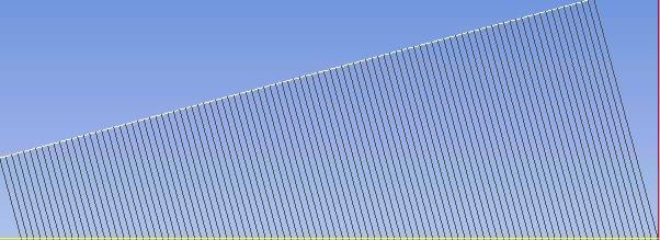

      The white line is the divergent wall, the yellow line is the axis, the black line is the created line. The created line begins on the wall and ends on the axis.

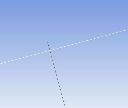

      I didnt't checked every line but all lines i have checked aren't exactly on the wall (I think it comes from numerical rounding error). Some of the lines goes out of the domain and some of the lines are in the domain.
      Example line a008:
      Here I zoomed very strong. Line a003 is like a008 in the domain too. But a003 works and a008 doesn't work.
      Another example: a007 goes out of the domain. This is a007 strongly zoomed in:
      a096 goes out of the domain too. But a007 works and a096 doesn't work.
