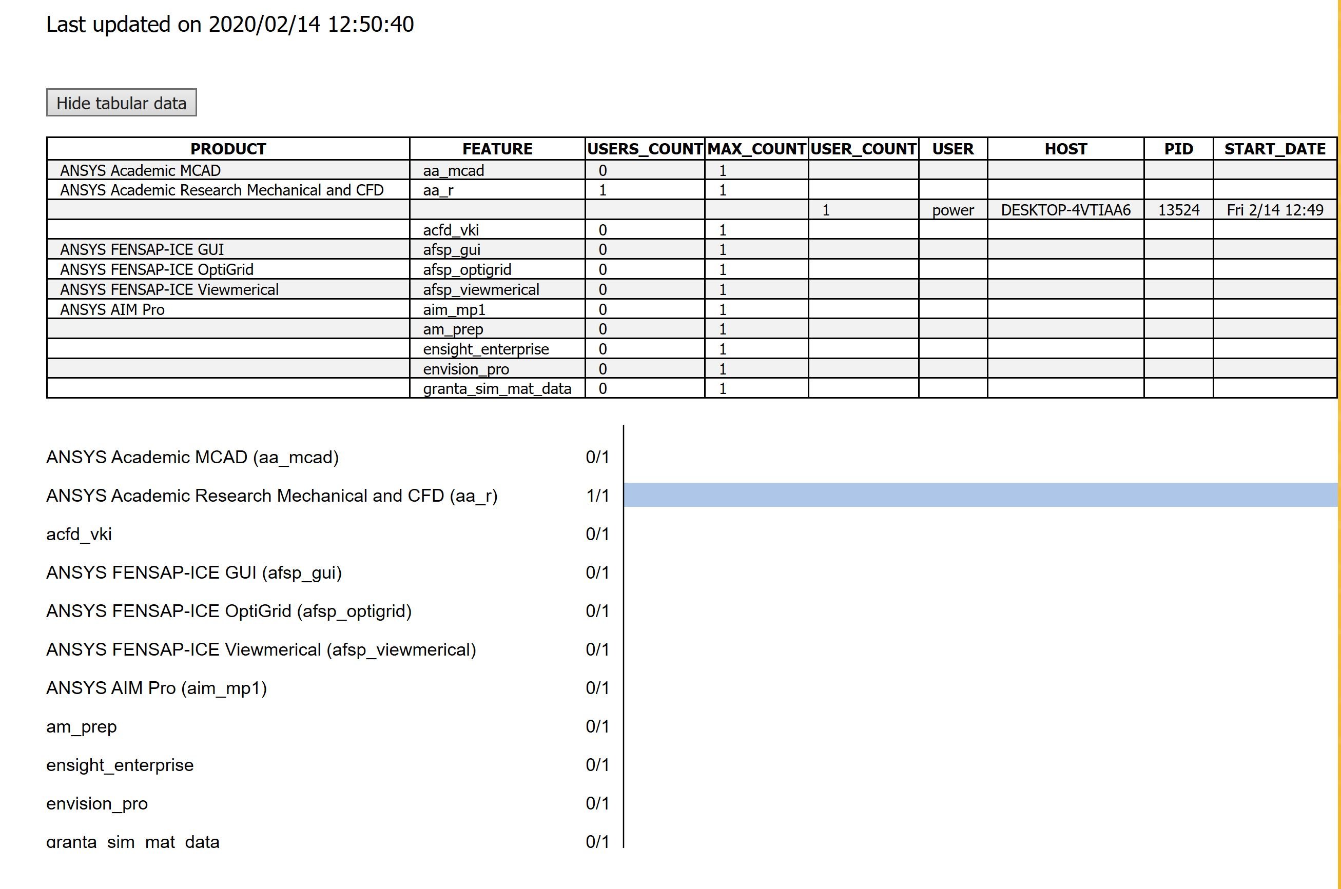

    • mobleysn
      I have the license management center up and running, yes. The "View Status" tab says that the license manager is running. I checked on the license usage and it appears to have activated the correct program:
      However, my v19 still does not show fluent, or acknowledge having CFD at all:
    • Keyur Kanade
      This question looks like as installation specific. Can you please create a question under category of 'Installation and Licensing' so that somebody from installation will reply. Please mention all details of your license in the question.
      Keyur
