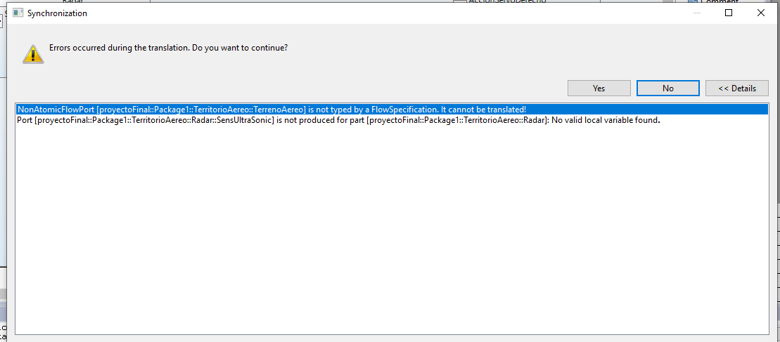

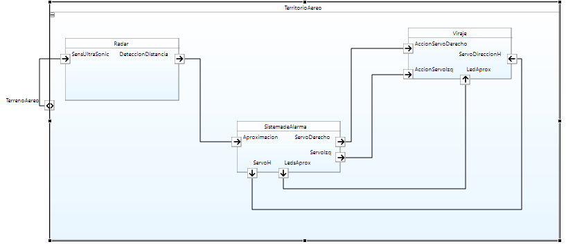

      Have a good day!
      I have a problem, When I make a "push" to create the suite architecture I see the errors in the second image, I believe that is for the in-out in the architecture, and The reason why that exist is because I have to connect an arduino with a sensor, could someone help me please why the errors?
      Architecture to create suiteError when I try to make a push to create suite

      The first error is most probably linked to the fact that you have created a "Grouped Flow Port"  namedTerrenoAereo. This port shall be typed by a FlowSpecification. You could use the Arhcitect Checker to verify consistency of your projet with the following rule:
      For the second error, you have created a Port SensUltraSonic that is never produced. You can also use the BasicCheck configuration of the Architect Checker to verify consistency of your project before trying synchronization.
      If the errors persist do not hesitate to share your porject and we will debug it for you.
