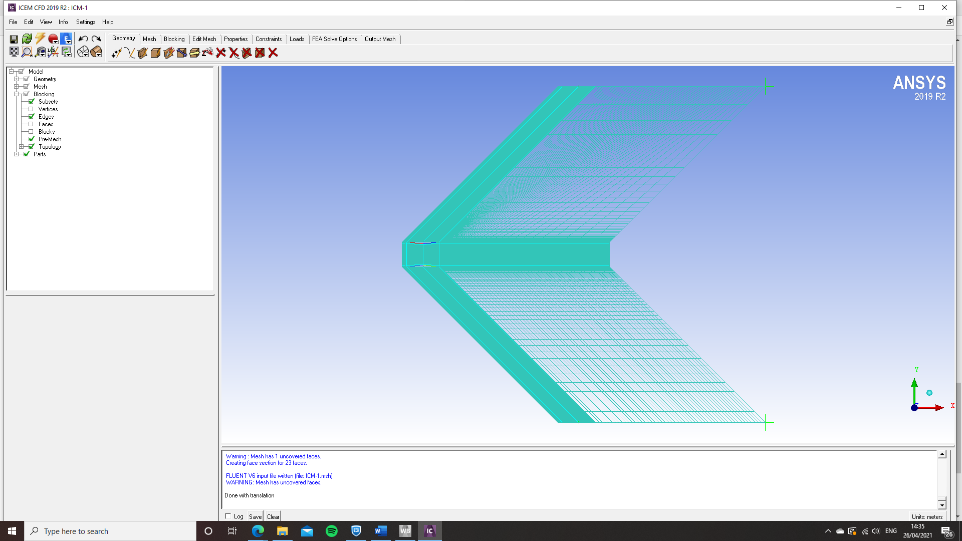

SubscriberHi, have these errors when loading up fluent after outputting my mesh from ICEM.nn> Warning: Ignoring WB preference save-post-processing-imagesnMulticore processors detected. Processor affinity set!nReading C:\Users\Oliver\Documents\CFD THESIS\hsdth_files\dp0\ICM-1\ICEMCFD\ICM-1.msh...nBuffering for file scan...nn16 nodes, binary.n9 quadrilateral cells, zone 7, binary.n12 2D interior faces, zone 8, binary.n11 2D pressure-far-field faces, zone 9, binary.nnBuilding...nmeshnauto partitioning mesh by Metis (fast),ndistributing meshnparts..,nfaces..,nnodes..,ncells..,nbandwidth reduction using Reverse Cuthill-McKee: 2/1 = 2nClearing partially read grid.nnError at host: Build Grid: Aborted due to critical error.nnError at Node 0: Build Grid: Aborted due to critical error.nn1: Cell is missing face: Cell 0, zone 7, (ID: 2): at location (-2.20000e+01, 5.31955e-07).nError at Node 1: Build Grid: Aborted due to critical error.nn===============Message from the Cortex Process================================nnCompute processes interrupted. Processing can be resumed.nn==============================================================================nnError: Build Grid: Aborted due to critical error.nError Object: #fnnMy othogonal quality is for my mesh lays in the 0.9-0.1 range. and the lowest quality on my mesh is 0.0865. Any help would be great.n -

SubscriberWhen running the exporter to fluent this message is now popping up.n Running FLUENT V6 Interface Vers. 18.2.0nn Creating a Fluent 2D mesh.n Computing connectivity for 9 cells.n Creating cell sections for 9 cells.n Checking mesh:n interior faces : 12n interior walls : 0n boundary faces : 11n Warning : Mesh has 1 uncovered faces.n Creating face section for 23 faces.nn FLUENT V6 input file written (file: ICM-1.msh) n WARNING: Mesh has uncovered faces.n -

Ansys EmployeeScreenshots please of ICEM CFD and the way you are generating the mesh.n -

SubscriberWhen running a check of the mesh it bring ups no errors. But when it exports to fluent it now brings up this line:nerror : domainfile contains no nodesn -

SubscriberYes it is.nChecking the mesh now brings up a message saying '909 problem elements were found. you can put them in a new subset Uncovered Faces, fix them by covering the exposed faces or ignore them'n -

Subscriberthe uncovered faces seem to be around the edge of my aerofoil. Not sure why it seems to have an issue with them. Trying it on fluent now brings up this error. Warning: Ignoring WB preference save-post-processing-imagesnMulticore processors detected. Processor affinity set! Reading C:\\Users\\Oliver\\Documents\\CFD THESIS\\hsdth_files\\dp0\\ICM-1\\ICEMCFD\\ICM-1.msh... Buffering for file scan...143596 nodes, binary.141780 quadrilateral cells, zone 6, binary.n281742 2D interior faces, zone 7, binary.n1818 2D pressure-far-field faces, zone 8, binary. Warning: Invalid face type 1. Skipping.Warning: Invalid face type 1. Skipping.Warning: Invalid face type 1. Skipping.Building...meshnauto partitioning mesh by Metis (fast),ndistributing meshnparts..,nfaces..,nnodes..,ncells..,nbandwidth reduction using Reverse Cuthill-McKee: 19239/256 = 75.1523nClearing partially read grid.nnError at host: Build Grid: Aborted due to critical error.0: Cell is missing face: Cell 1226, zone 6, (ID: 1912): at location (-2.24827e+01, -1.79742e+00).nError at Node 0: Build Grid: Aborted due to critical error.n1: Cell is missing face: Cell 1226, zone 6, (ID: 72802): at location (-2.24827e+01, -1.79742e+00).nError at Node 1: Build Grid: Aborted due to critical error.nn===============Message from the Cortex Process================================Compute processes interrupted. Processing can be resumed.==============================================================================Error: Build Grid: Aborted due to critical error. Error Object: #f
