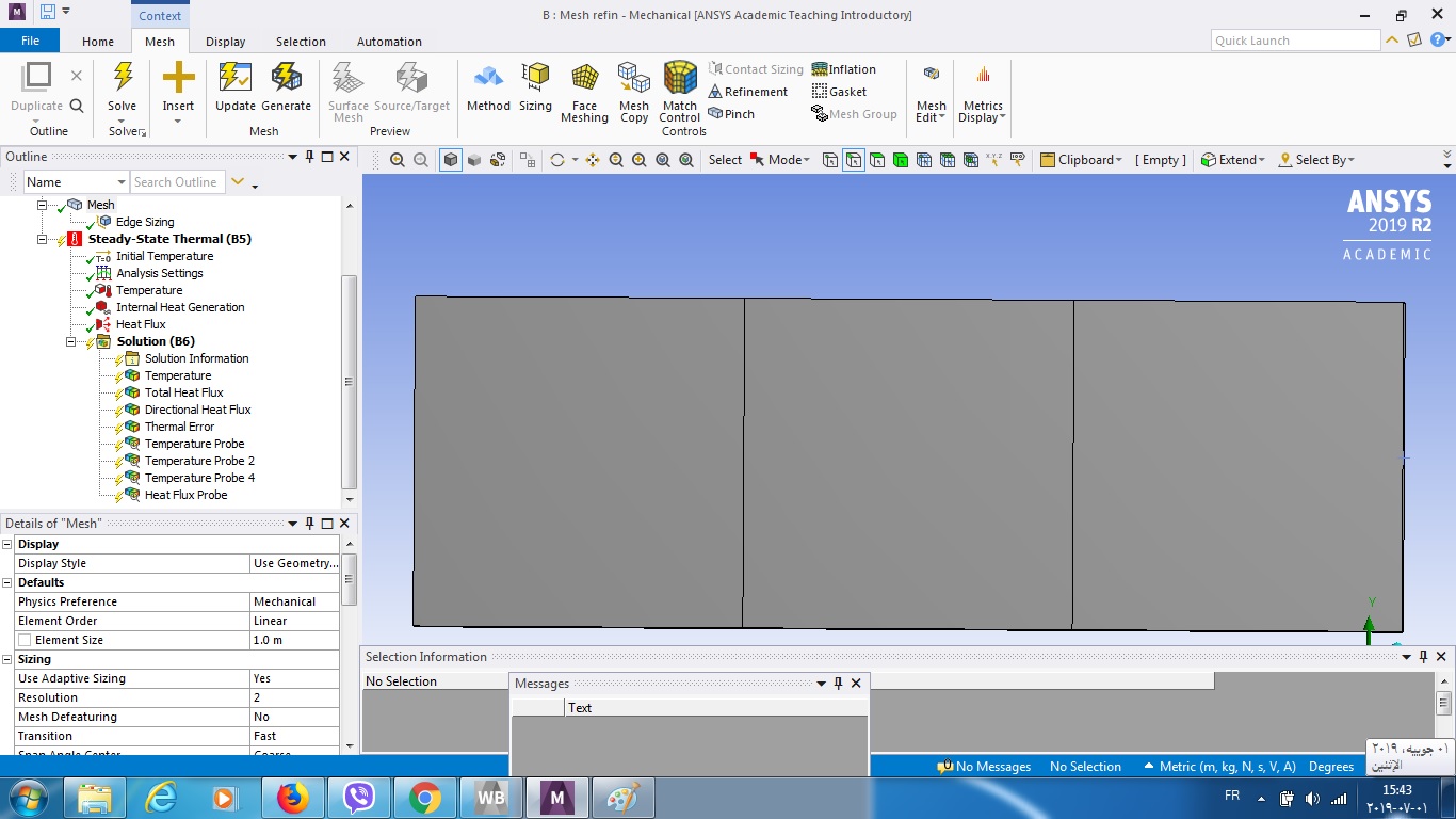

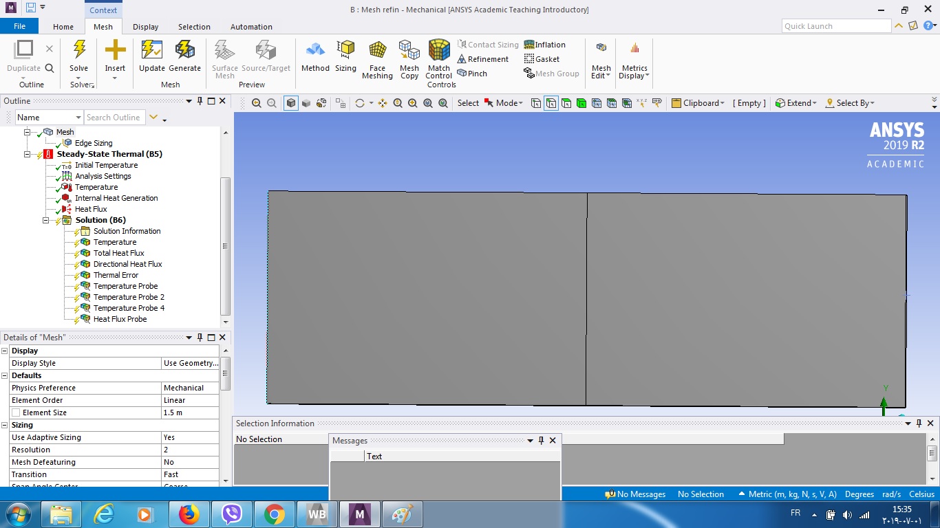

SubscriberYou need to add the Face Meshing mesh control to the face. That prevents triangles from being used. Then you can assign number of elements along the edges and it will work.
