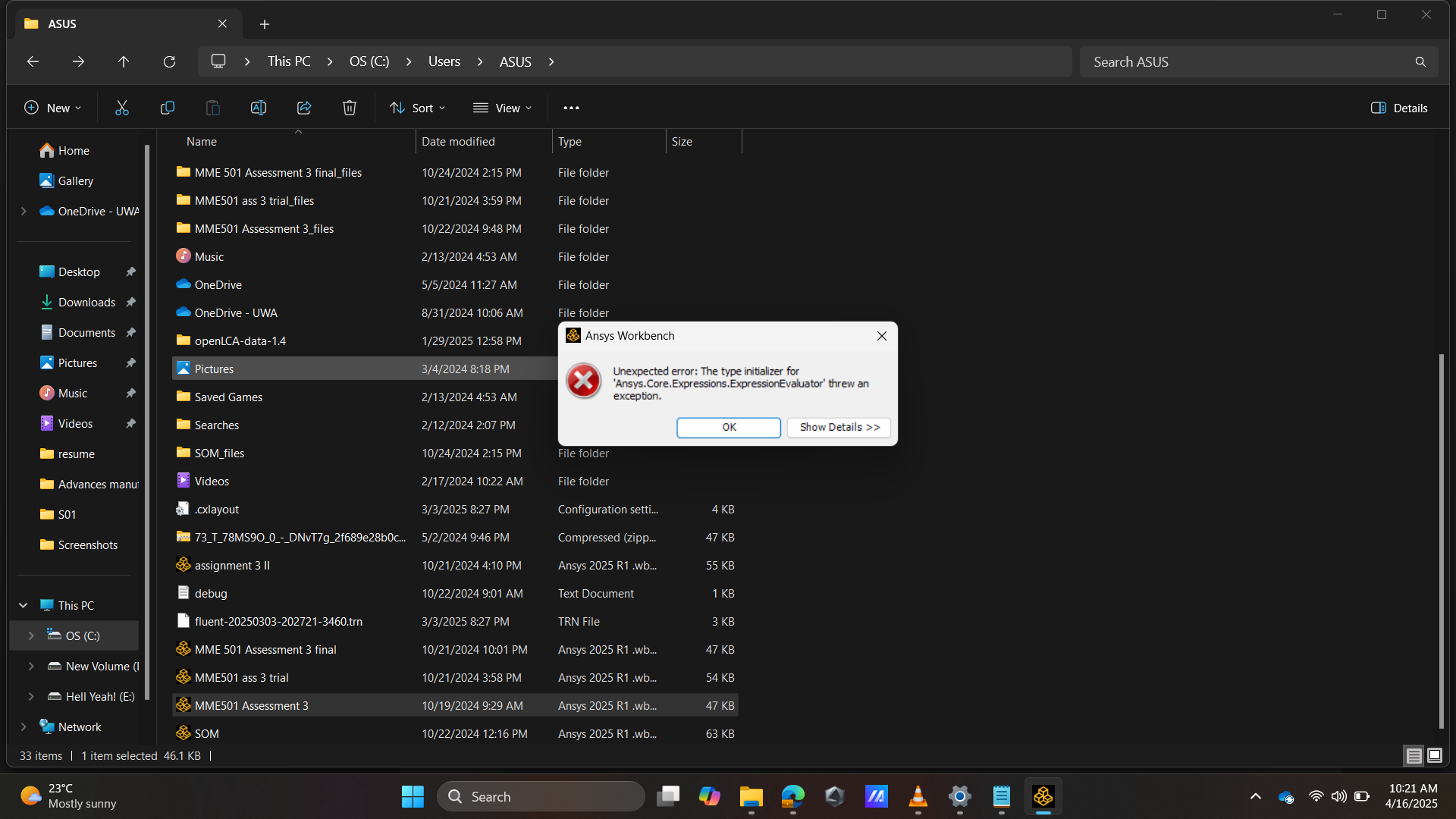

May I know which Ansys version and application you have installed?

This is ANSYS 2025 R1 student version. Is there any way this problem can be solved?ÂÂ

SubscriberThis is ansys student 2025 R1Â

Goto %appdata% and rename the Ansys folder to Ansys.old, relaunch the workbench
