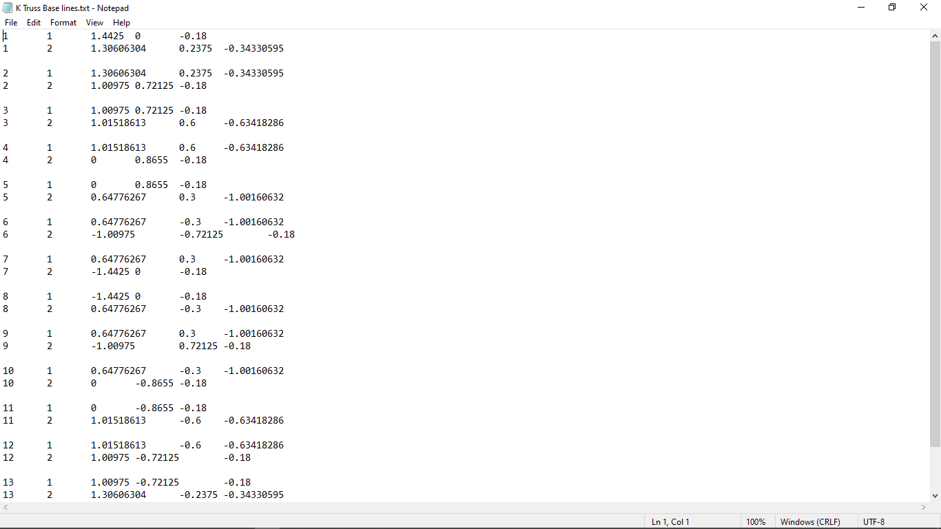

Forum ModeratorPlease confirm that you are using format as shown in :
https://ansyshelp.ansys.com/account/Secured?returnurl=/Views/Secured/corp/v195/wb_dm/dm_3dcurve.html
-Aniket
May 31, 2020 at 4:57 am
June 1, 2020 at 4:34 am
Aniket
Forum ModeratorPlease check the first link in my signature to see how to open the link. Your format is incorrect, Remove first two lines from the file and check.
-Aniket

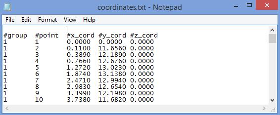

November 6, 2022 at 12:18 am
fikal6013
SubscriberDear All,
”Error Reading Coordinates File.” when i tried to import curve coordinat. Any suggestions on what to do for solving this problem?Thank You
