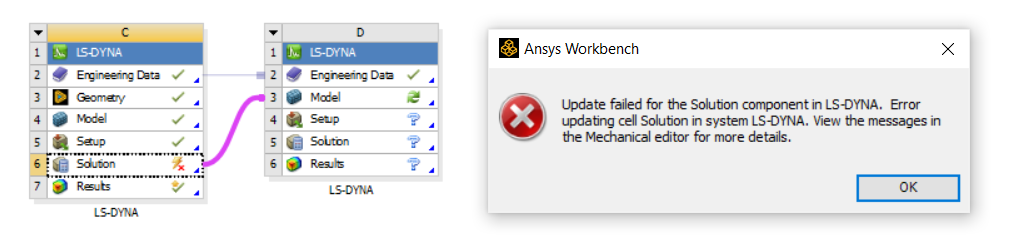

      Hello LS-Dyna forum,
      I have a successful simulation as seen below. However, when I try and transfer it to another model so I can do the second step of my solution, I get an error of "Error updating cell solution in system LS-DYNA.". I am using Ansys Workbench 2022 R2.

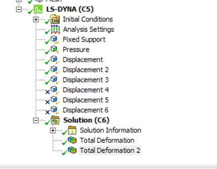

      Here is model tree showing successful solution.
      Here is the view of model from project schematic.

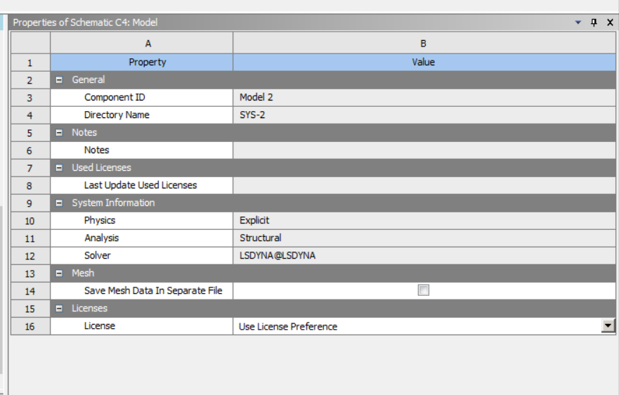

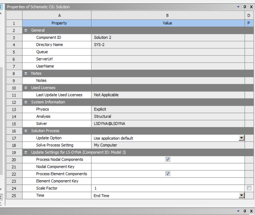

      Here are the properties of the Model and Solution cells.

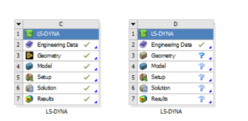

      Here is me inputting second model.

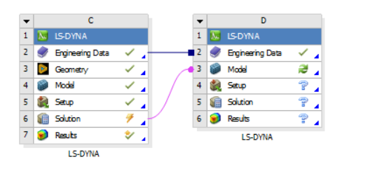

      Here is me connecting the solution cell of successful model to the model cell of the new model.

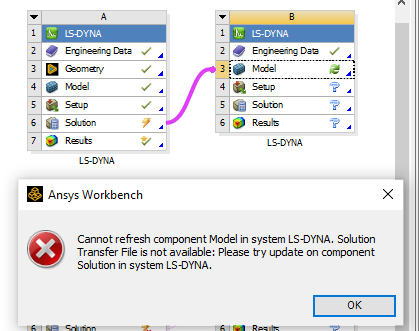

      Here is the error I get when updating solution component.
      Here is the error in the messages tab.
      I would greatly appreciate some input on this as I have been struggling with this problem for a while. I thought it might be a problem with my download of 2022 R1 so I updated to R2 but I am still facing this issue.
      Thanks in advance,
      Ben

      Hi, are you writing the dynain file using the write file for flexable parts option in the settings of the lsdyna system?, what you are trying to transfer, deformed geo or dispalcement or stress.
      cheers, Ram

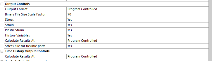

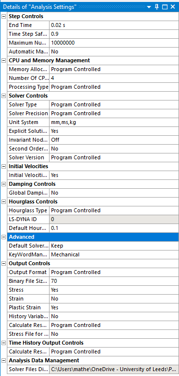

      Thanks for the reply. Here are my settings:
      I can't see a write file for flexible parts option. Please could you advise on where to find it. I would like to transfer deformed geometry.
    • Ben_Ben
      I see the stress file for flexible parts now. Will put to yes and see if it makes a difference.
    • Ben_Ben
      I changed my output controls to: And I still recieved the same errors:

      Hi you need to first map the materials into second system and then transmitt the deformed shape.
      Cheers Ram
    • Ben_Ben
      Hi Ram,
      This time I mapped enineering data across and then did solution to model after and I still got the error.
      Cheers,
      Ben
    • Ram Gopisetti
      hi can you check for dynain file in the file directory of this project, can you be able to laod it via external model then plug it to lsdyna system !
    • Ram Gopisetti
      something as above.
    • Ben_Ben
      Hey Ram,
      That worked. Thanks for your advice! Really appreciate it.
