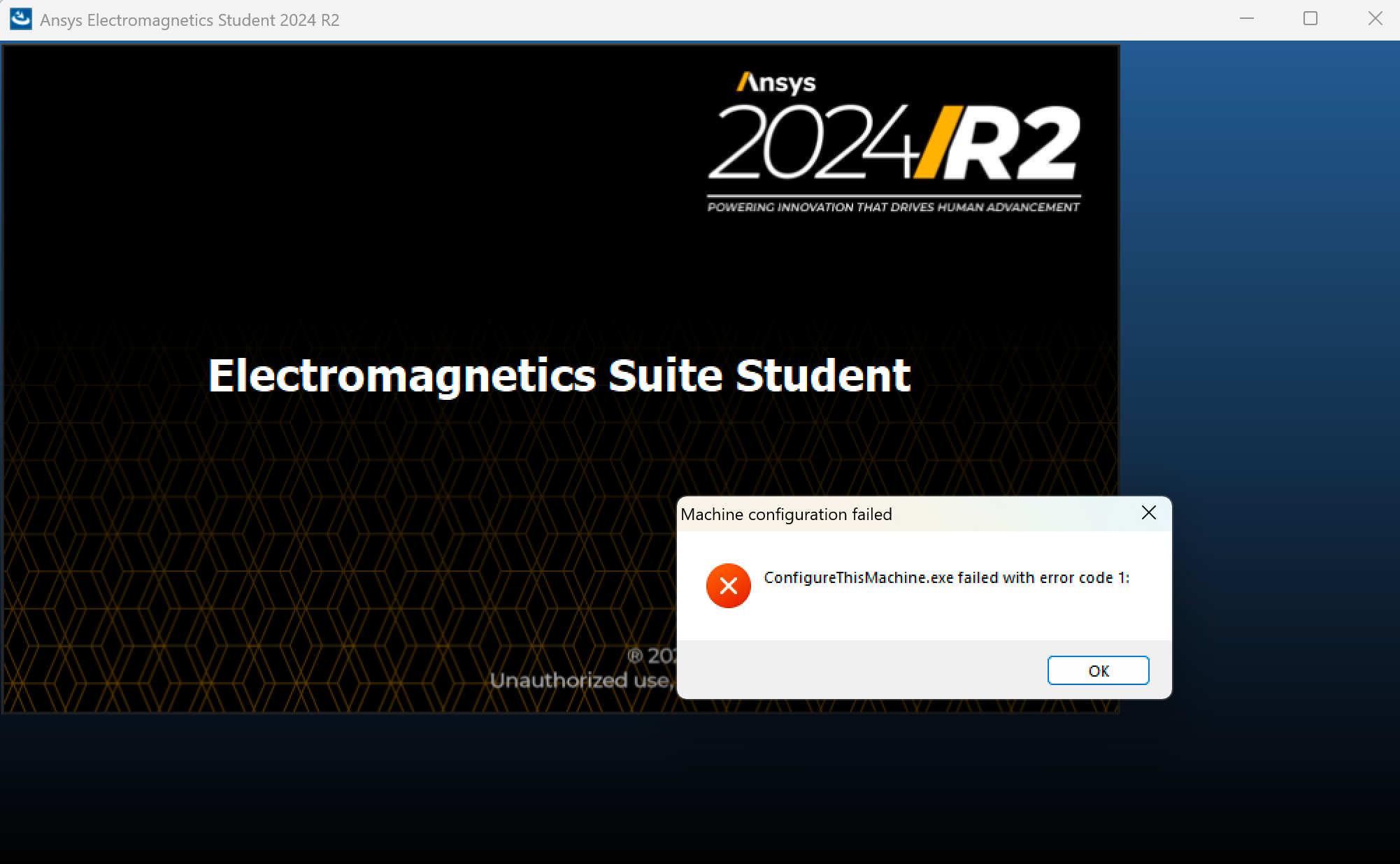

      I am trying to download the Ansys Electronics Desktop Student  - Free Software Download 2024 R2, but when I try to install it, I am running into this issue:
      How do I resolve this issue?

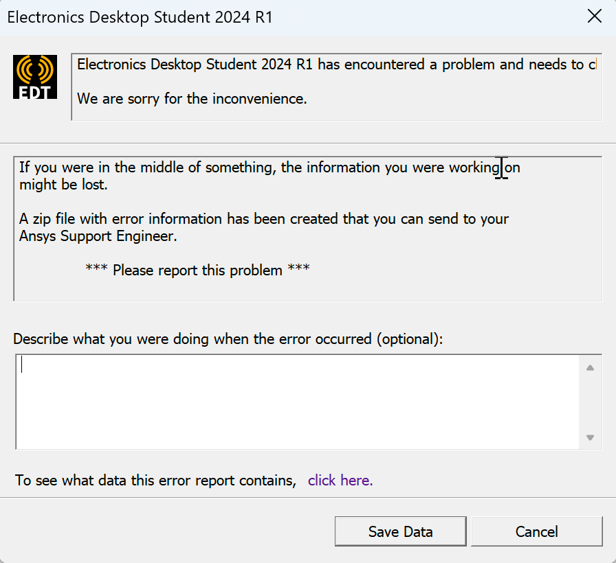

      Note: If I click "OK", the installation completes; however, when I try to use HFSS like I try to draw any geometry, it crashes, and I get this error:
      How can I resolve these issues?
    • Rajeshwari Jadhav
      Please try the following potential resolutions in the following order:
      Solution 1:
      set environment variable.
      Go to START > ‘Edit the System Environment Variables’ > click Environment Variables.
      Under the System Variables, please click NEW and create a new variable. ANSYS_EM_DONOT_PRELOAD_3DDRIVER_DLL=1 to disable the call and check if it resolves the problem.
      Solution 2:
      1. Update the graphics driver
      2. Go to C:\Program Files\AnsysEM\v241\Win64\config, then right click on the "ConfigureThisMachine.exe" and run as administrator.
      Solution 3:
      1. Open Windows File Explorer and type this in the address bar %TEMP%
      2. Make sure that your system can see hidden files, then look into this %TEMP% directory for a copy of ConfigureThisMachine.exe.init.log and delete this.
      3. Go to C:\Program Files\AnsysEM\v241\Win64\config , then right click on the "ConfigureThisMachine.exe" and run as administrator.
      Solution 4:
      Rename C:UsersDocumentsAnsoft  to Ansoft.old
