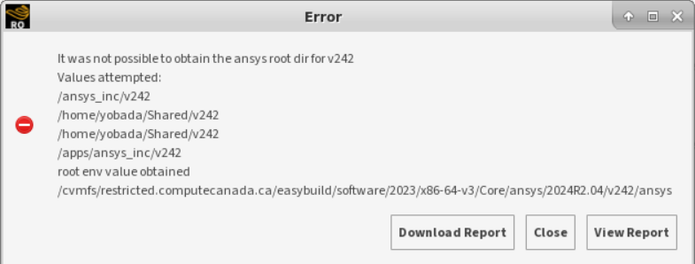

SubscriberHello,ÂI am trying to Couple Rocky and Fluent on a supercomputer.
Through the Rocky interface, I selected Help -> Tutorial Workshops -> 14.Tutorial - Fluidized Bed -> Downloaded the dem_tut14_files.zip file from section 14.1.5.
Then, from Rocky interface, File -> Open project -> selected the file tutorial_14_B_pre-processing-restart.rocky in dem_tut14_files\dem_tut14_files\tutorial_14_B_pre-processing\

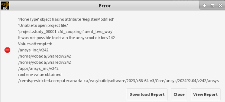

But I got the attached errors (error_1 appears first).
Could you please inform me how to solve this issue ?
error_1:
error_2:
error_3: -

Check if you have a version of Fluent compatible with Rocky installed in one of the locations indicated in the first error message.

There is a Fluent version compatible with Rocky. How can Rocky be configured to use that Fluent for the coupling case?
