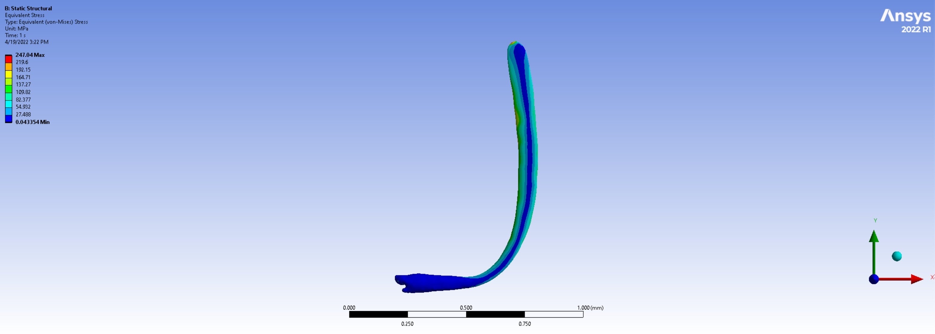

SubscriberI'm having a problem with "Large Deflection" in ANSYS Mechanical,
When I run my analysis with Large Deflection OFF, I get my solution, but it's weirdly distorted.
April 19, 2022 at 7:46 ampeteroznewman
SubscriberSince you don't know how much force to use, delete the force and instead use a Remote Displacement of 0.1 mm in the Y direction leaving all others Free. Scope it to a small face or edge at the tip. You can insert a Probe to get the Reaction Force on the Remote Displacement.
