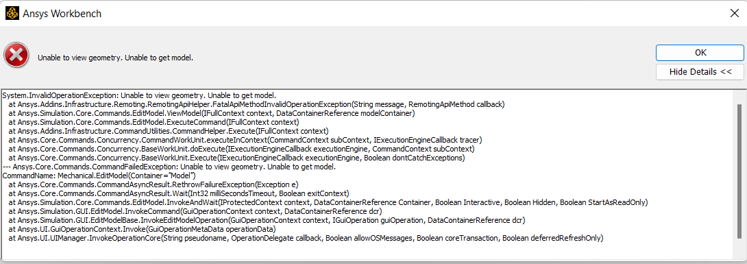

March 21, 2022 at 5:25 am
Rosterzr
SubscriberI was performing a static structural beam deflection simulation in ANSYS 2022 R1 (Student version). It consists of a simple rectangular cross-section beam subjected to a uniformly distributed load and 2 edge boundary conditions. I created its geometry in the design modeller and then moved onto the model section. I meshed it, applied loads and boundary conditions and solved it. Upon solving it, if I click on, let's say "Directional deformation", to observe the results. After about 5 seconds, ANSYS Mechanical automatically shuts down itself leaving behind the project schematic window. If I click on "Model" again, it opens ANSYS Mechanical briefly for about 2 seconds before shutting down again after displaying an error. I can't even visualize my results, because it keeps shutting down whenever I click on any of the options on the left side in ANSYS mechanical, after solving.
PFA the error displayed.
I don't know how to resolve this. Please help me out as soon as possible!
March 22, 2022 at 5:45 pmGeorge Karnos
Ansys EmployeeUnder the %TEMP%\WorkbenchLogs directory you should see logs from the session.
Can you check those and post any errors you may see?
Please post the error, not the file as we are not permitted to open files.
Thank You

May 9, 2022 at 3:08 pmtdevlieger
SubscriberI have a similar issue and my logfile shows the following:

May 9, 2022 at 3:25 pmGeorge Karnos
Ansys EmployeePlease refer to the following discussions:
Workbench Extensions Manager "Root element is missing" ÔÇö Ansys Learning Forum
Piezo and MEMS Extension install error ÔÇö Ansys Learning Forum
You can also search for "Root element is missing". This will bring up more discussions.

May 17, 2022 at 1:37 pmGeorge Karnos
Ansys EmployeeTry the following:
Make sure no Ansys programs are running
Go to :
%APPDATA%\
(This should take you to a directory: C:\Users\\AppData\Roaming\)
You should see a directory named: Ansys
rename that directory to: Ansys.old
Now try to run.
May 17, 2022 at 2:31 pmtdevlieger
This works, thank you, you really helped me out with this. Had been struggling with this for 2 weeks now.

May 18, 2022 at 12:30 pmtdevlieger
SubscriberOkay this worked for 1 day and now I get the similar message again. Once the message occurs in a certain file, it keeps coming back there and I need to restart my entire process of making an analysis.
Is there a permanent solution for this problem? Thank you beforehand.
Below I provided the error message I get:
And the workbenchlog of this error:

May 18, 2022 at 1:01 pmGeorge Karnos
Ansys EmployeeDoes it start again if you remove the %AppData\Ansys directory?
Do you have Virus protection installed?
What happens if you disable it and any firewall as a test?
What happens if you start Workbench in the following way:
right-click on Workbench 2022 R1 and choose: more->run as administrator

August 14, 2023 at 5:35 pmAmaranth
SubscriberHello All,
I am getting same error as well..
here is how it looks:
I am getting the same error too. I tried renaming the previous ansys file to ansys.old and the reopened the workbench and loaded the file. I still get same error. let me know if I need to do anything else ?
I tried renaming the file as .old as well and it still does not run.
Any help is appreciated
