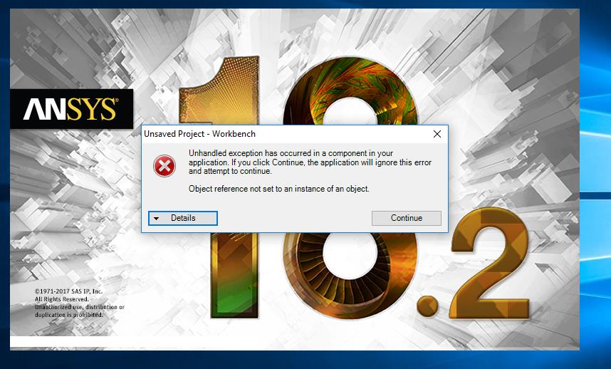

      I got an error when transferring results from fluent to CFD-Post.

      Problem started when i first opened CFD for a project last night. Now when i open ansys from desktop  the above error prompts.
      Should i reinstall ANSYS?

       Rename %AppData%Ansysv1xx and try start CFD-Post outside of WB. If still not working then reinstall the most actual release with explicit admin rights (RMB and run as administrator). The same applies for uninstall (as admin).

      When i opened the project from archive (Wbpz) format. It transferred the results to CFD.

      That means the old project was corrupt.
