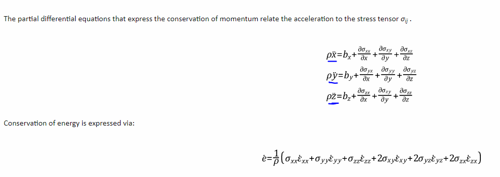

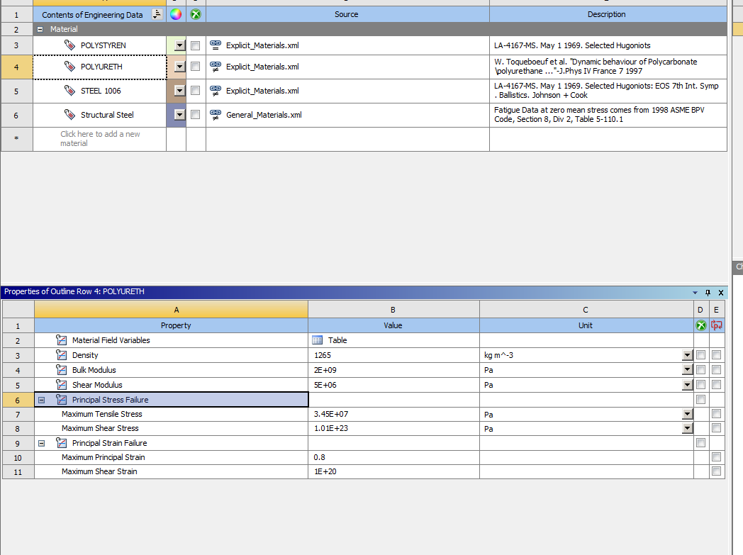

      Hi I am trying to do a tension test on a dog bone specimen with the material being polyurethane. I keep encountering this error of time step being too small. The same model works well with steel1006. Please let me know what parameter is called as time step and in the theory of explicit dynamics which parameter is time?
