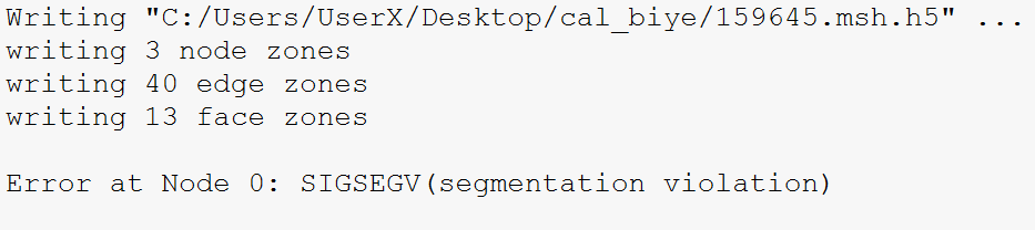

I encountered an error while using Fluent Meshing to generate a surface mesh. After setting up rotational periodic boundaries and optimizing mesh quality, I am unable to save the file. The error message is:Â Error at Node 0: SIGSEGV (segmentation violation). How can I resolve this issue?
 I successfully saved once after setting the periodic boundaries and optimizing the mesh initially, but subsequent optimization attempts failed to save.Moreover, I can proceed to set up boundary layer meshes, but similarly, I am unable to save the project or generate the volume mesh.The error at this stage is still Error at Node 0: SIGSEGV (segmentation violation).
