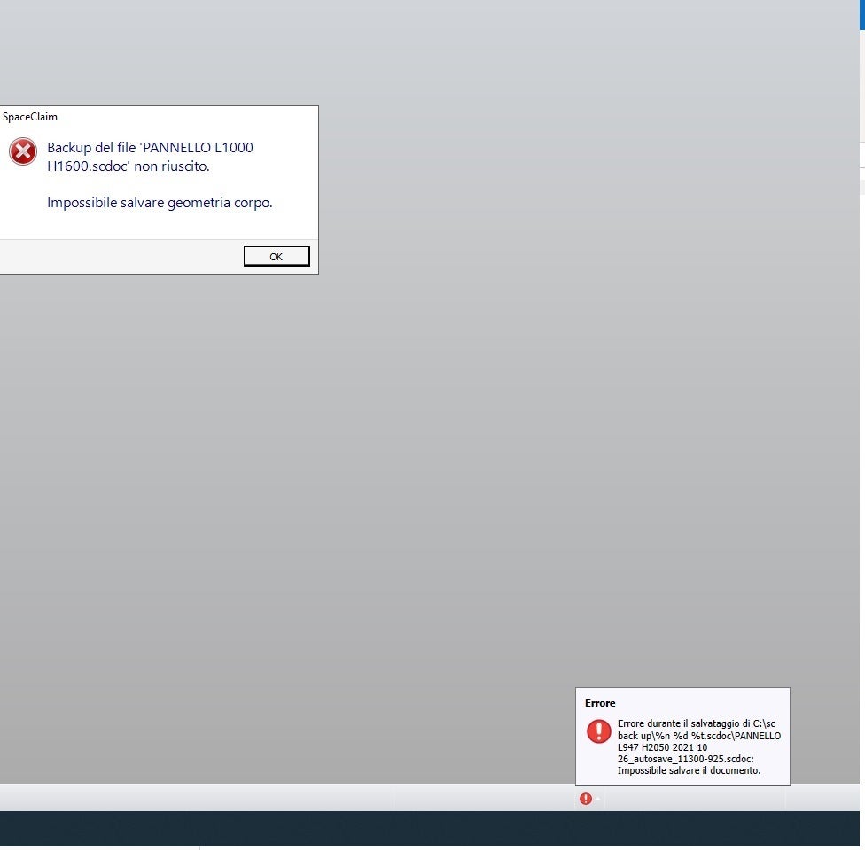

Subscriber🛈 This post originally contained file attachments which have been removed in compliance with the updated Ansys Learning Forum Terms & ConditionsHelloÂ
I can't share files.
This error often happens how can it be solved?
I have attached the log files where the error occurs.The error only happens to the customer on a computer
Can you give me an answer within a week?
Thank youBest Regards

I do not see any error in the log files. Can you please check if this issue occurs when the application is "run as administrator"?
May 19, 2021 at 2:09 pm
Roberto Granito
SubscriberHello Subashni
The computer has administrator rights, if I click on the icon with the right mouse button and I run it as administrator the file I can no longer open it because the server no longer sees me.
In the video that I have attached you there is the description of the error, usually why that error might come out?
Best Regards
May 26, 2021 at 9:49 am
Subashni Ravichandran
Forum ModeratorHello Roberto
The error says another document exists in the existing path. Can you please ask the customer to try saving the file at a different location?

I've already tried, the error says something wrong as there is no other document in the path

It does this on both of the company's computers, could it be something related to Windows rights? Is it possible to unlock Windows security on some specific SpaceCliam folder inside C :?
Computers both have administrator rightsBest REgards

I just checked this is a bug and it has been reported. (bug number 351019)
I have updated the bug report with these findings as well.
