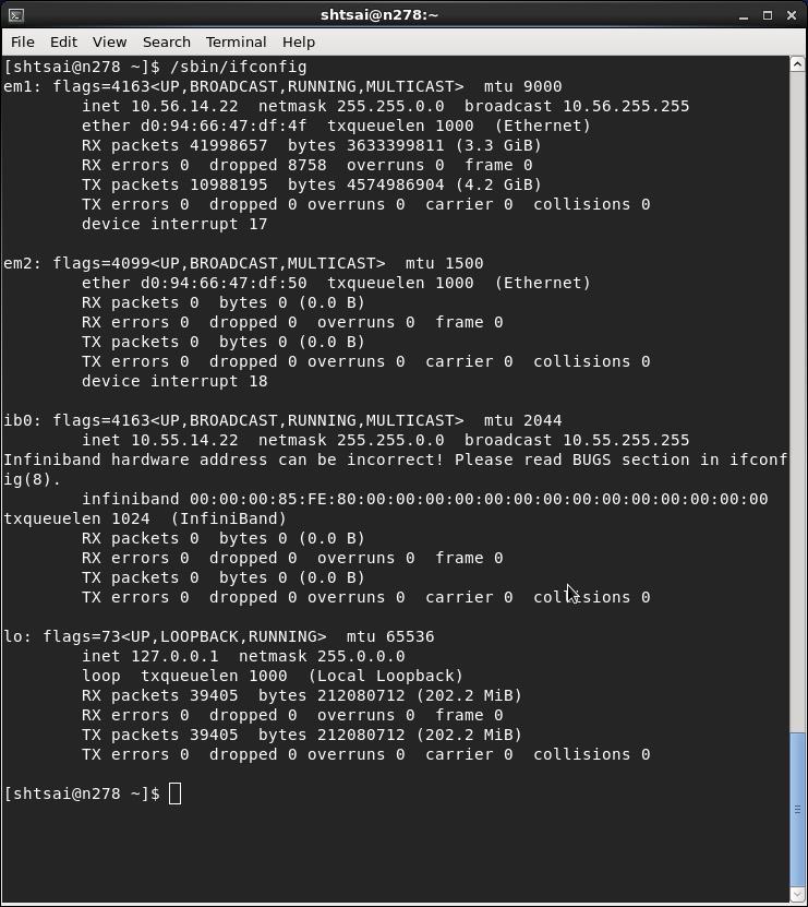

      When I run the ansysedt command with 'HFSS/MPIVendor'='Intel', but use 'HFSS/RemoteSpawnCommand'='SSH', and export the environment variable I_MPI_TCP_NETMASK=ib0, such as (using bash shell):
      export I_MPI_TCP_NETMASK=ib0
      ansysedt  -distributed  -machinelist list="n278:4:10:90%,n279:4:10:90%" -monitor -ng -batchoptions  "'HFSS/EnableGPU'=0 'HFSS/HPCLicenseType'='pool' 'HFSS/MPIVendor'='Intel' 'HFSS/RemoteSpawnCommand'='SSH'" -batchsolve HFSSDesign1:Nominal:Setup1 SampleDesign.aedt
      (where n278 and n279 are the two hosts allocated to the job by the queueing system), I still get the error:

      I also tried to export I_MPI_TCP_NETMASK=ib and I_MPI_TCP_NETMASK=255.255.0.0 (our netmask), but these didn't work either.
      What is the correct way to define the I_MPI_TCP_NETMASK variable? Is exporting it before invoking ansysedt an appropriate way?

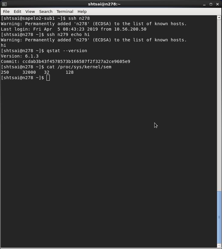

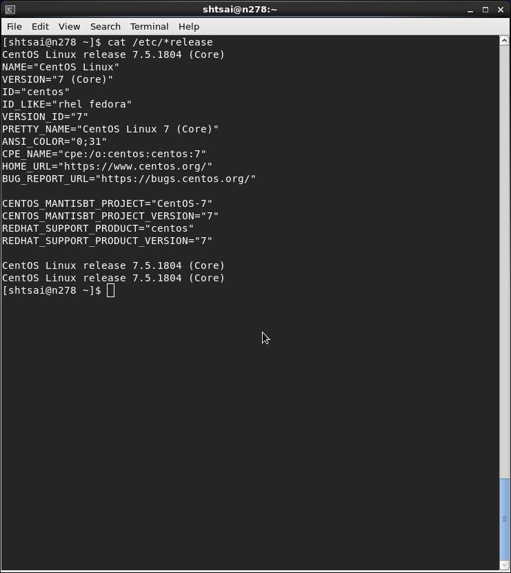

    • ANSYS_MMadore
      Hi Shan-Ho,
      Please provide the following:
      1. Location of the AnsysEM installation - ex:  /opt/AnsysEM/AnsysEM19.1/Linux64/ansysedt
      2. Screenshots of the following six commands (run in succession)
      $ ssh n278
      $ ssh n279 echo hi
      $ qstat --version
      $ cat /proc/sys/kernel/sem
      $ /sbin /ifconfig  - Please remove the space between /sbin and /ifconfig. It will not post properly on the forum if I take out the space.
      $ cat / etc/ *release
      Thank you,
      Matt

      Hi Matt,
      Thank you so much for your response. Please see the screenshots above.

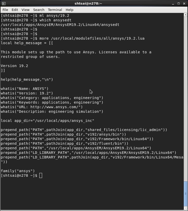

      Hi Shan-Ho,
      Thank you, that should help.
      Please provide the installation location of AEDT as well.
      thanks
      Randy
    • shtsai

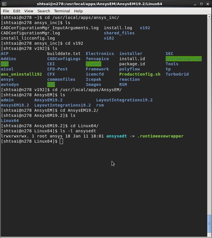

      Hi Randy,
      The ansysedt command is installed in /usr/local/apps/AnsysEM/AnsysEM19.2/Linux64
      I'll post a screenshot below of our installation dirs.
      Is this what you mean by AEDT?
      Thanks so much for your help!
      Shan-Ho

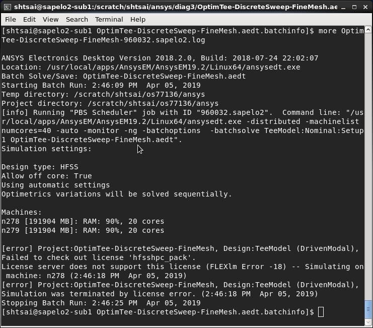

    • shtsai
      Hi Randy,
      Yes, I submitted the job with "qsub job.sh" and the job got allocated nodes n278 and n279. Per your suggestion, I copied the sample file OptimTee-DiscreteSweep-FineMesh.aedt to my working directory and submitted the job to the queue, using "qsub job.sh" (and using your job.sh file). This job also appears to only use one of the nodes (n278).
      Is there a way I can attach the log file to share with you? I haven't found this option, so I will post an image of the beginning of the file OptimTee-DiscreteSweep-FineMesh.aedt.batchinfo/OptimTee-DiscreteSweep-FineMesh-959886.sapelo2.log

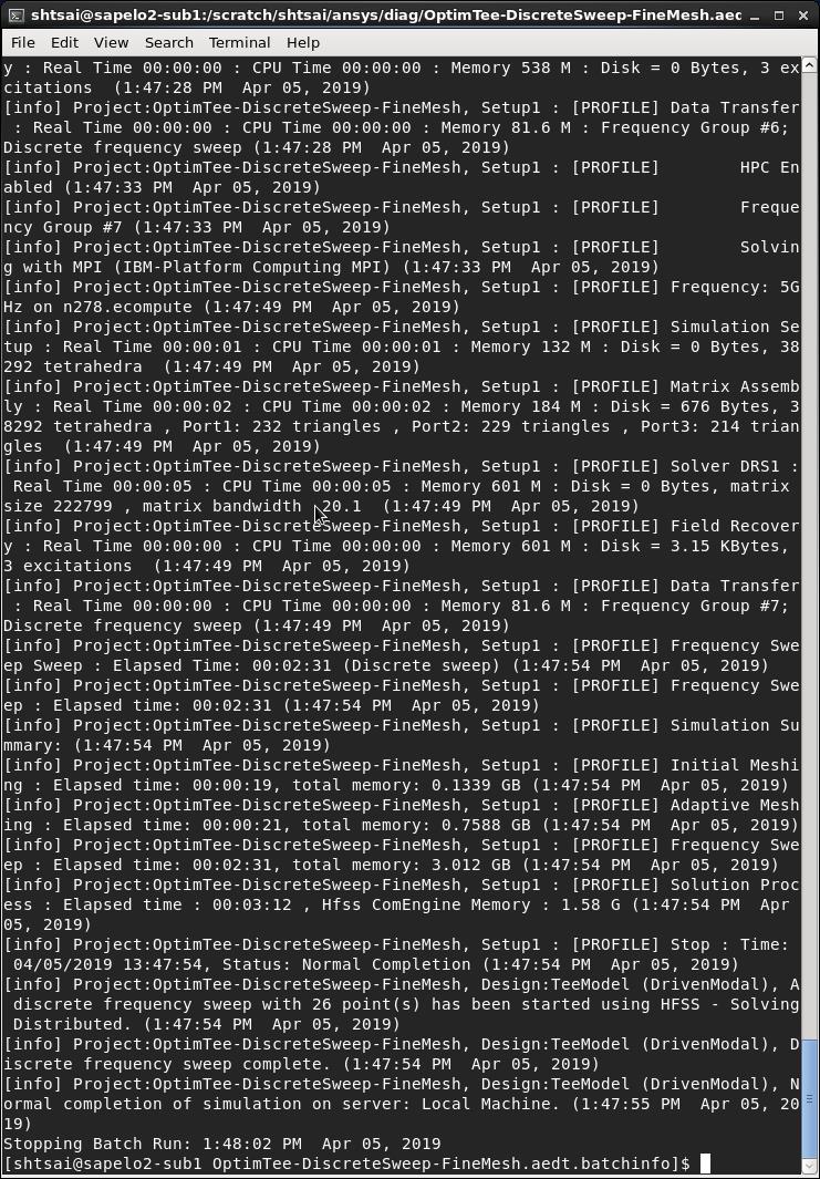

    • shtsai
      And the last page of OptimTee-DiscreteSweep-FineMesh.aedt.batchinfo/OptimTee-DiscreteSweep-FineMesh-959886.sapelo2.log is
    • randyk
      Hi Shan-Ho,
      Header of that file was sufficient to show it recognizes it is running under a PBS scheduler.
      However, it is apparently failing to parse the $PBS_NODEFILE as it is referencing "localhost" and not the assigned solver nodes.
      Please try once more without:
           export ANSOFT_PBS_VARIANT=pbspro
      share the top of the OptimTee-DiscreteSweep-FineMesh.aedt.batchinfo/OptimTee-DiscreteSweep-FineMesh???.log
      thanks
      Randy
    • shtsai
      Hi Randy,
      When I don't export ANSOFT_PBS_VARIANT=pbspro, the job appears to determine the nodes correctly, but the licensetype is then set to pack. What is the best way for me to set this to 'pool'? (the config/default.XML is still there, unchanged).
      Thanks so much!
      Shan-Ho
