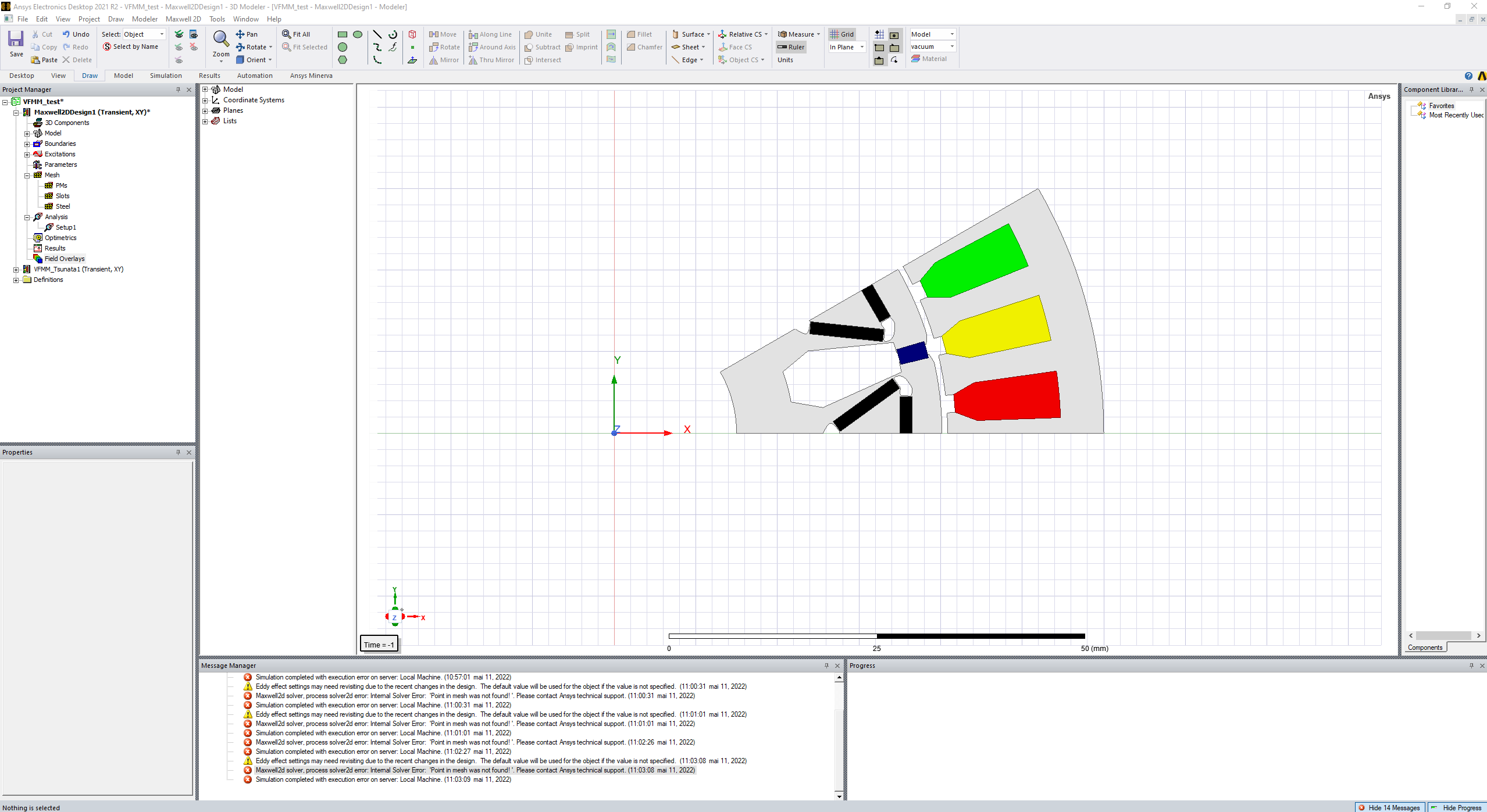

I am analyzing a specific motor using Maxwwell 2D Transient in AEDT 2021 R2, I set up the model manually, it's an IPM synchronous motor (see attached file). When I analyze it i keep getting this error :
Maxwell2d solver, process solver2d error: Internal Solver Error:Â 'Point in mesh was not found! '. Please contact Ansys technical support.
Any idea what might the problem be ?
Anis
May 16, 2022 at 3:50 pmNKC
Can you try the following?
Add a dummy band object between the band and stator airgap.
Under in initial mesh setting, move the slider towards a more fine setting.
IF this did not work, change the mesh Method to classic in the Initial mesh settings and check.
Regards Navya
May 17, 2022 at 11:23 amguessoum.anis
SubscriberHello,
The 2nd an 3rd solutions worked, thank you :)
Have a nice day
Anis
