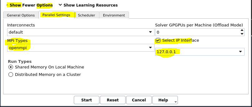

      Hello
      try these settings in Fluent launcher
      in fluent Launcher click on more options >> then go to parallel settings tab >> under mpi types select openmpi
      or if using command line then add “-mpi=openmpi” without the quotes to the command line
      hope this helps
