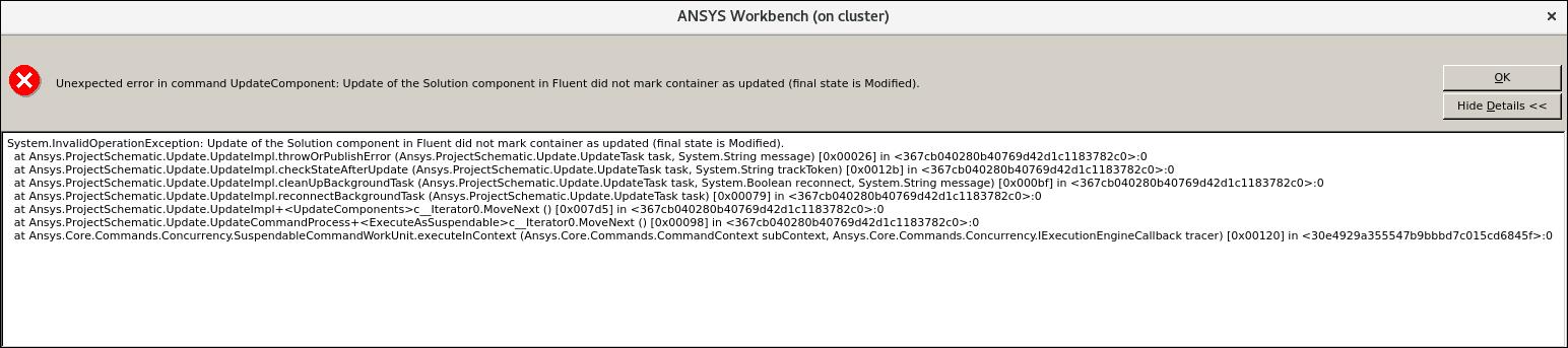

I am attempting to send someone a model through workbench so that they can run it on their computer. We have gotten the files loaded and saved on the other computer, but when attempting to run it, it gives the following error (see photo screenshot). The model is a VOF to DPM. As proposed, I checked if Aluminum was deleted from the materials, and it is not, it is still listed, so that should not be causing the error.

Forum ModeratorDid you archive the project before moving it? If you do then unarchive/extract Workbench will sort out all of the paths etc in the new project; otherwise links can become unstable and/or broken.Â
Alternatively if you're running Fluent you can also export (or write) the case & data out and then run Fluent in stand-alone mode. This may help as you're only transferring the files you need rather than geometry, mesh etc.Â

Forum ModeratorSIGSEV means something has failed in the parallel system, this can be triggered by a setting (as above) or the system. I'm slightly surprised that you can't launch Fluent in standalone mode - it's usually easier than using Workbench!Â
Please can you archive the project and then send it over?Â

SubscriberWe tried archiving, sending, then unarchiving, and the same error occurred.Â
I have attached the screenshots sent to me regarding the error if that helps.Â
When running in standalone fluent after being sent, the model runs temporarily, then reads error:Â
"Error at host:Â
failed to open file
MPI Application rank 0 exited before MPI_Finalize() with status 2
The fluent process could not be started"

Forum ModeratorIf it's running for some iterations then failing is it trying to read/write any files? The tool uses PUMA adaption, so it's possible this conflicts with something within Workbench, but I'm not aware of any issues.Â
January 23, 2019 at 4:00 pm
soloviev
SubscriberIt seems that the error after running for a bit occurs right after the first time Fluent writes files. I will attach the text of that error as well, it may be helpful.Â

Does it run on local computer without any issues? Please check permissions and quota on cluster
By the way I recommend using HDF file format whenver you are working with gradient apdation.

Forum ModeratorYou also need to make sure you set the system to save case & data otherwise you won't be able to open the data files.Â

Ansys EmployeeAre you writing some DPM reports?

SubscriberIt does run locally without errors. I am only writing a particle export file, no other reports other than case and data files.Â
I will have them check the permissions and quota, as well as ensure the case and data files are being saved on their end.Â
